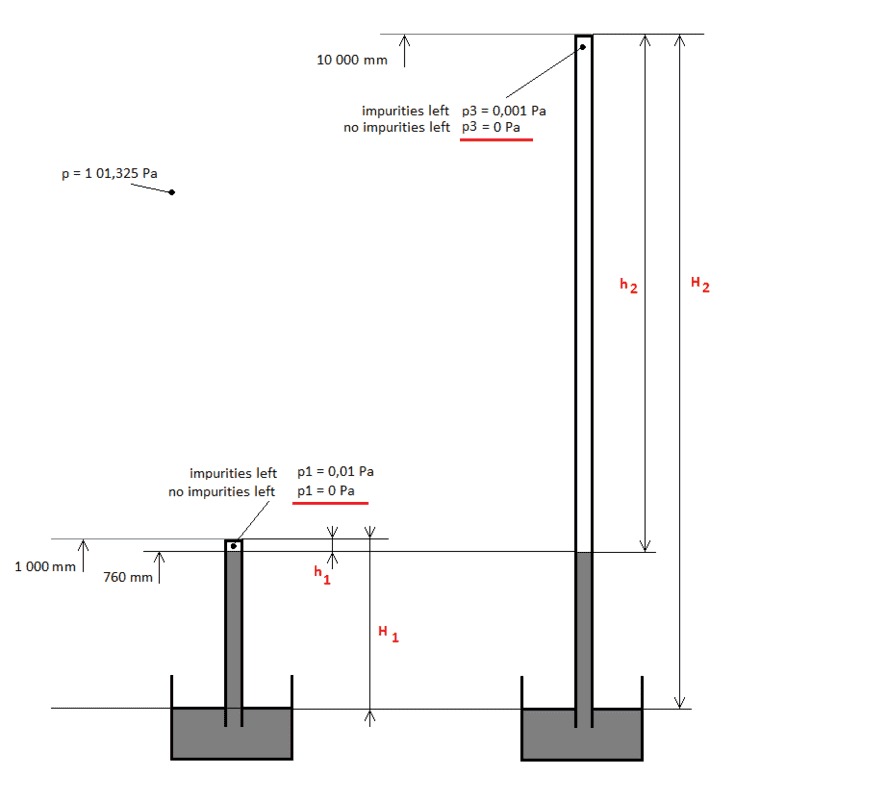

In the case of theoretical Torricelli vacuum test, when no impurities left in the vacuum: Is the vacuum 0Pa for 1m height (with 760mm of Hg) or 10m height of the test column?
Does the real vacuum pressure/underpressure depends only on the amount of impurities?
In the case of theoretical Torricelli vacuum test, when no purities left in the vacuum:
Is the vacuum 0Pa at 1m height (with 760mm of Hg) and also the same at 10m height (also with 760mm of Hg) of the test column?
Theoreticaly is the vacuum (0 Pa) the same at 1m and at 1km of the test column height?
see the immage.

hubajs said:
Summary: In the case of theoretical Torricelli vacuum test, when no impurities left in the vacuum: Is the vacuum 0Pa for 1m height (with 760mm of Hg) or 10m height of the test column?
So theoreticaly is also 0 Pa at 1 km of the test column height?
. . . . . and how would you propose to get a column 1km high? (Hint, perhaps on Jupiter?)
This is not a question about how to engineer a structure (thats why I use the word "theoreticaly").
But OK, let's modify: "So theoreticaly is also 0Pa at 10m of the test column height?"
Ah I understood your "Jupiter" comment now! Thank you, I clarify:
By the column height I mean the "H1" and "H2" in the new image here below.
I am interested by "H1" and "H2" difference impact to the vacuum "p1" and "p3" difference.
Theoretical question: When pressure p1=101,1325Pa. Is also the p3=101,1325Pa?

@hubajs
I understand your post.
But not your second ( When pressure p1=101,1325Pa is not a vacuum )
for a first order evaluation,
Knowing that P(h) = ρ g h , would you be able to give your own answer for the difference, if there is a difference, in pressure between the two heights of the "vacuum" column.
@256bits
my bad, p1=101,325kPa is copy paste error. The question was meant to be this:
Theoretical question: When pressure p1=0Pa. Is also the p3=0Pa?
Assumption:
1) reality: vacuum presure "p" can be within an order 0Pa < p < 3.325Pa (for -98Pa underpressure from 101,325kPa)
2) theory: vacuum mass density for theoretical 0Pa is ρ=0kg/m3
Evaluation of my example with P(h) = ρ g h :
mercury part: height doesn't change => pressure difference is 0Pa.
vacuum part: theoreticly there is ρ = 0 kg/m3
vacuum part: realistic, in case of impurities in the vacuum ρ > 0 kg/m3 => Δp > 0 and some pressure difference may occure, but this will be within this range: 0 < p3 < p1 < approx 3.325Pa (for -98kPa underpressure from 101,325kPa)
Conclusion:
theoretical case 1: no impurities in the vacuum 0Pa
=> no matter how small or high is the "h" (1cm or 100m).
=> p1 = p3 = 0Pa will still be the same for all heights cases
This is the goal of my original question. Is my conclusion correct?
I don't believe my conclusion, that's why I ask here. :confused:

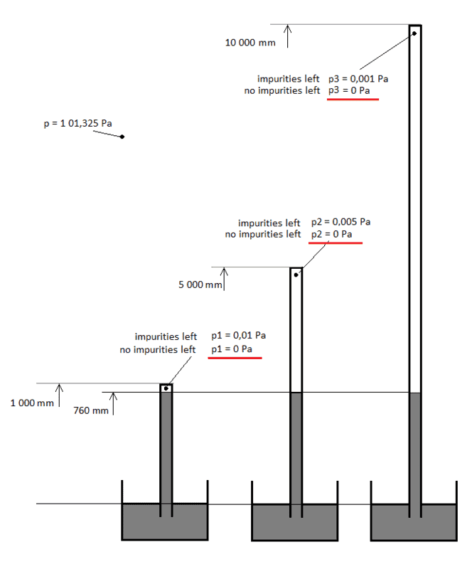

I don't understand your question- the 'empty space' is actually not a perfect vacuum due to vapor pressure of the fluid. Are you asking how the density of that vapor varies in height due to gravity?
OK, lets, see. I am the most interested by theoretical explanation where I assume p1 = p3 = 0Pa for all heights which is quite weired to me.
Please everyone, let's stay within Newton's world, no quantum physics. :-)

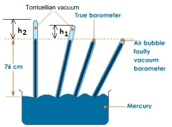

I need theoretical advice on Torricellian vacuum pressure and tube length relation to vacuum pressure (see the new image here).
What happen when I use 10000mm long tube? Will the h2=8240mm?
Is the Torricellian vacuum pressure p = 0 Pa for 1000 mm long tube?
Is the Torricellian vacuum pressure p = 0 Pa for 10000 mm long tube? Also?
Yes!
The length and cross-sectional area of the tube have no effect on the height of the fluid column of a Torricelli barometer. The pressure at the top of the fluid column is always equivalent to the vapor pressure of the liquid at the ambient temperature.
Nature of the "impurity" will not be important.
I just need to know the theory limit of vacuum pressure I have to take into account in my calculations.
I prefer to stay within the theory frame and not enter to the real world for now.
My further application lowest pressure I wish to reach should be between 0.1 Pa and 1.0 Pa.
