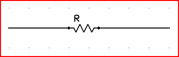

There exists only one current in a circuit: What I take that to mean is simply that there is a movement of electrons through the circuit wires.
Does that mean that electrons move at different speeds at distinct parts of a circuit like, say, before and after a resistor? No, that would imply a different dQ/dt, therefore different currents. I'm confused as to how we can measure different voltages before and after a resistor in a circuit, but the current be the same along the circuit..
Any simple circuit like the picture attached..
There is a voltage drop across the resistor, but if there's different voltages, why not different currents?

Imagine an analogy with water.
A pool of water rests on the ground. A pump is used to move the water from that low altitude to the top of a complex arrangement of pipes, valves, and whatever other trickery you like.
At the top of the arrangement, the drops of water have a large amount of potential energy. As they fall through the arrangement, they lose energy. Perhaps some drops turn a waterwheel or do other useful work, converting their potential energy into some other form.
Make sure to let the pump run for a while, so everything reaches steady-state.
If you then take a horizontal cross-section through the entire arrangement, you will find that the flow of water through it is constant. Most of the water might go through one large pipe, while only a small amount may go through others, but the total flow of water is the same through any horizontal cross-section.
Electrons behave the same way in circuits. A "pump," a battery or other voltage source, gives the electrons energy. They "fall" through the circuit toward lower energies, giving up their potential energy.

Don't confuse current and voltage concepts. The current is the amount of charge or water that flows through the "pipe". In a single ideal circuit path, that is the same in the circuit at a particular moment in time. The voltage is related to the amount of potential energy the charge has at any given point to transfer to things like resisters.
At one end of the resister a certain amount of charge passes in during a certain amount of time, or I=dQ/dt. There is no where for the current to go except out the other end of the resister. The resister doesn't have charge accumulating someplace inside it. However, the voltage, or potential energy of the charges can be converted into heat, for example. So the charges can lose energy to the resister. This lost energy shows up as a drop in voltage across the resister.
They reason they don't slow down due to lost energy is because the charges in the "pipe" behind them are pushing them along, and so on, back to the battery which is ultimately supplying the energy that the charges lose in the resister.

If you take 10 resistors and place then in series across a power source you can take an ammeter and measure the current by opening up the junctions of the resistors and you will always find it is the same wherever you measure it.
Electrons or charges do not get "used up" as they pass through a resistor.
This is a well known and easy to prove practical result, but you may well choose to believe otherwise if you like.

The resistors and power source are in a loop. Whatever voltage is produced by the power source appears the resistors in the same ratio as their resistance. No resistor is more vulnerable to the voltage than any other because the current flowing through all of them is the same. The current depends on the voltage and the total resistance in the circuit.
The voltage developed across each resistor is proportional to its resistance and these voltages add up to the voltage supplied by the power source.

I think the water analogy has confused you about what current is. It's true that when water flows through a pipe restriction (resistor) it's speed increases. But that's not what current is. Current is the amount that flows past a certain point in a given amount of time. If you measured this in the narrow restricted part of a pipe and compared it to the wider part of the pipe you would find that they are both the same. The different speeds are analogous to voltage. The higher the speed of the water, the higher the voltage drop. So if you have two restrictions in a pipe, one more restrictive than the other, then the one with the most restriction will have the highest speed water going through it (higher voltage drop). But all parts of the pipe will have the same flow rate (current).
The water analogy is a good one for learning the basics of electricity. But after that it can cause confusion, so you should leave it behind. One reason is that an electrical resistor dissipates energy in the form of heat. A restriction in a pipe does not, at least not to the same extent that an electrical resistor does. And the speed of the current carrier (electrons) does not change when it passes through a resistor. The reason for this is that the current carrier in an electrical circuit is moving at near the speed of light, and it's mass is extremely small. So we can think of electricity as a transfer of energy only.

This makes sense to me. With resistors, V=I*R, so with I held constant, the relation is clear. I suppose then the problem was I didn't intuitively assume that water flows at the same rate along any section of a complex arrangement of pipes, which in a sense, has to be true. Like the poster above said, water particles push the ones in front along, and so on, so they have to travel at the same speed.
Thanks for the help everybody, simple concepts I know, but I deserve to suffer for not paying close attention in my introductory physics courses.
