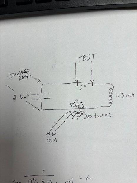

I want to measure tank circuit currents using *different* methods. Below is the tank circuit. The coupling transformer has 20 turns and has 10A @ 80khz going through it. This means there should be a maximum of 200A in the tank (20:1 turns ratio). I measure the voltage across the 2.6uF capacitor and get about 150 Vrms. With a capacitative reactance of about 0.75R this equals 200A.
I now want to measure the voltage across 1 inch (25.4mm) of the 1/2" copper tubing (TEST, mislabeled as 2") that serves as the conductor for the tank. The tubing has an outside diameter of 15.975mm. With a skin effect of .2mm @80kHz I get:
R = p*L/A
A = pi/4 * (15.875^2 - 15.475^2)
L = 0.0254m, A = 0.00000984m^2, p = 1.7x10-8 R-m
This gives R = 0.000044R
When I measure the voltage across 1 inch of pipe under the same conditions I get 3.4Vrms.
A = V/R which would be over 700,000A. This can not be correct. What am I missing?
NOTE: voltage measurements are done with oscilloscope

I don't want the resistance of the tank. I want the resistance of the 1 inch segment and current through it. My question is about the discrepancy between my measurements.
Am I making the TEST voltage measurement incorrectly?

No. The capacitor and work coil voltages cancel. The actual voltage across the coupling transformer is much lower. The current, thought, is very high.
I'm doing it just to understand how these things work...and to heat metal.
Is the oscilloscope probe grounded or differential? There is some magnetic flux in the signal which is not surprising. Can you draw earth grounds on your test sketch?
I was using a differential probe. The tank is floating and not grounded.

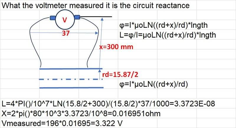

In my opinion it is about the circuit reactance.
Handwritten-style diagram of a voltmeter connected to a loop of two parallel conductors, with x = 300 mm and rd = 15.87/2 marked, plus formulas for flux, inductance L = φ/I and calculated values L = 3.3723E-08, X = 0.016951 ohm, and Vmeasured = 3.322 V.
imsmooth said:
This correlates with what I measured.
But when measuring current, you want real resistance only, you do not want to include reactance in the shunt.
In post #8, I explained how to eliminate the inductance of the wire from the voltage drop across the resistance. You need to minimise the area of the meter connection loop.
(I hope the message is quoted)
No it isn't. Well I am replying to @Babadag
I am sorry but could you please explain what you did here?

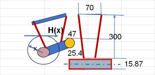

The way I would go is to compute the magnetic field generated by the large current in the pipe circuit, then compute the flux intercepted by the measurement loop by surface integration, and convert its time derivative into the EMF that will almost entirely appear across the voltmeter.
But you seem to compute the inductance of... What exactly? The lengths seem those of the measurement loop, but the current is that of the copper pipe circuit.
What am I missing?

I had to revise my calculation.
The inductance formula is incomplete.
Theoretically, the magnetic field around a conductor where a current flow is
H=I/(2*pi()*x) [A/m] if x is the radius from conductor centre line up toany point outside.
B=μo*H the magnetic flux density [Wb/m^2]
dφ=B*length*dx
dφ=μo*H*length*dx
dφ=μo*I/(2*pi()*x)*length*dx
φ=μo*I/(2*pi()ln(xmax/xo)*length.[Wb]
If xo=D/2 and xmax=300+D/2 then:
φ=μo*I/(2*PI())*LN(xmax/xo)*length
μo=4*pi()/10^7 [H/m]
L= φ/I= μo /(2*PI())*LN(xmax/xo)*length [H] total magnetic flux through area.
If length=(my appreciation) 47 mm average then:
L=4*pi()/10^7/2/pi()*ln((300+15.87/2)/(15.87/2))*47/1000 = 3.43909E-08 H
Reactance=2*pi()*f*L=2*pi()*80*10^3*3.439/10^8 = 0.017286747 ohm
Voltage drop VD=196*0.01729= 3.388202414 V
[neglecting the resistances]
  • Hand-drawn diagram of a copper conductor loop: a blue rod with a yellow circle at its end and a red-dotted circle, beside two red-outlined sides and a red-boxed bar; labels include 70, 300, 47, 25.4, 15.87 and H(x).

My problem is with this part of your computation
L= φ/I
Where, it appears, φ is the flux in the measurement loop, while I is the current in the copper pipe branch alone.
Are you using some partial inductance mathematical 'trick'?

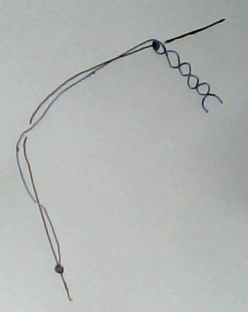

For wavelengths longer than the shunt, you only need one turn around each straight segment of the shunt. If the shunt is a braid, you can pass the meter-wire up the middle of the braid, like the core of a coaxial cable.
Any chance you could sketch this?
Maybe this sketch will help. Keep the wire close to the shunt. Then the twisted pair goes to the voltmeter for current computation.
Hand sketch of a wire loop with a coiled, twisted pair of leads: one wire runs from a bead-like shunt to a helical twisted section, and two thin wires run down to a second bead and a short loose end.
I thought this is what you meant. Why the single turn from the lead on the left? Why not have both test leads meet midway in the section under test and start twisting there?

You have one turn over each short length, and pull it tight, so it does not pick up local EMI.
You can do that, but usually you have the meter at one end of the resistor.
