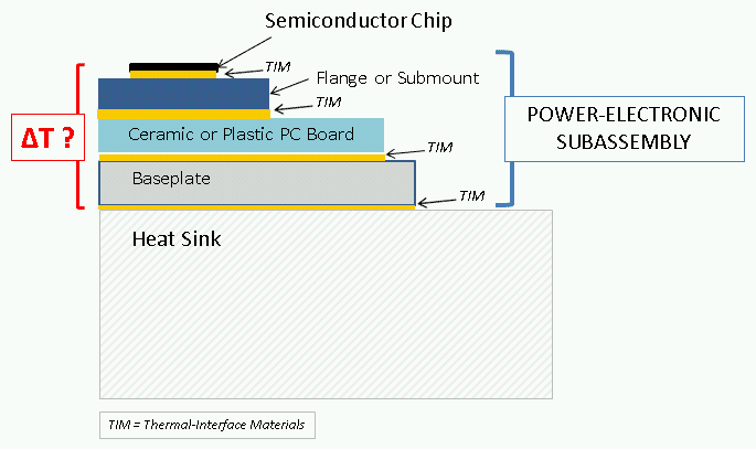

A representative cross-section of a power-electronic subassembly is shown below.
Cross-section diagram of a power-electronic subassembly: semiconductor chip on a flange or submount, over a ceramic or plastic PC board, over a baseplate, over a heat sink; TIM layers between each, with a delta-T bracket on the left.
NOTE: Layers of thermal-interface materials (TIM) connect the various interlayers together, both thermally and mechanically (hardware may be required).​
In traditional discrete surface-mount power devices (SMPD) and mechanically-attached power devices, such as the TO-220, the temperature difference between the power semiconductor and the bottom of the device baseplate or ‘case’ -- ∆Tjunction-to-case – is an important metric in ensuring safe operating conditions.
Assuming that the generic POWER-ELECTRONIC SUBASSEMBLY shown above is a single ‘power device’ enclosed in a case with a metal-baseplate bottom, the device should have a consistent temperature difference during full operation between its heat-generating power semiconductor(s) and the heat sink surface to which the device baseplate is attached, or ∆Tjunction-to-case.
What is the temperature drop between the semiconductor chip(s) and the heat sink (∆Tjunction-to-case) in conventional applications that handle high-power loads, generating lots of heat to be dissipated? High-power applications include:

There are some errors in what you posted. When heat sinking is important there will be no ceramic or PCB FR4 material between the power component's external thermal metal pad and the heat sink it is mounted on. Look up how a TO-220 package is typically mounted to a heat sink.
The slight variation on that is when the exposed thermal metal pad on the power component is not a ground (like for PNP power transistors used in push-pull type power stages). In that case there is a thin Mica pad that is placed between that exposed metal and the grounded heat sink. Thermal heat sink grease is also used to lower the ##\theta## thermal resistance.
There is also an option to mount the high-side power component to a heat sink directly if that heat sink is not user-accessible. Otherwise you would risk folks getting a nasty shock if they touched the heat sink... (do not ask me how I know this!) o0)

Sorry, I'm not a packaging engineer ... and I got that stack-up schematic from a colleague who is also not a packaging engineer. And, yes, FR4 is absolutely horrible for thermal dissipation, compared to ceramic, etc.
I just wanted to show a simplified internal stack-up for, say, maybe a DC/DC-brick power supply with a bonded aluminum baseplate with a number of interlayers. (I do know that the tiny semiconductor in a TO-220 is generally soldered directly to the nickel-plated copper baseplate of the device, maximizing thermal dissipation, before the device over-molding with epoxy.)
While I would like to learn all I can about the packaging aspects of the interlayers, I want to consider them all encompassed into a 'single package' -- is the term here 'case', or something else? -- so that the magnitude of the ∆T during operation between the power semiconductor(s) and the heat sink surface can be compared across various device designs and applications. Even educated guesses would be helpful...
Here's an uneducated guess for a baseplated power supply with its semiconductor(s) running at 125oC: The ∆T might be 30oC, between the chip junction and the heat sink surface.
It's straightforward to monitor heat sink surface temperature during operation ... the temperature of embedded semiconductors under full power not-so-much.

These are not difficult calculations. However, you'll need a scenario to analyse with real data, things like power flow, temperatures, area, thickness, thermal conductivity, etc. The heat flow path is something that needs to be designed, there are many different ways to do this, most are constrained by the application so the idea of optimization is complex.
I see no real point in guessing. Sure, it could be 30oC, or something else, it depends on the application. It's like asking how big the engine is in an automobile.
Perhaps your best approach for now would be to search the web for sample designs, or heatsink design guidelines so you can see how it's calculated and then do some of your own scenarios to get the comparisons you seek.

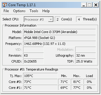

Since CPU subassemblies have had built-in silicon temperature sensors / thermo diode monitors for years -- see below the ‘Core Temp’ report on my cheesy laptop’s CPU – as an on/off switch for its cooling fan, I guess that I assumed that this temp-sensing technology might be common in other high-power applications…
Core Temp 1.17.1 window showing Mobile Intel Core i3 370M processor readings: Tj. Max 105°C, Core #0 73°C, Core #1 71°C, both at 0% load.
…it’s certainly been around long enough. Here’s nifty 1999 overview from Analog Device on the exciting new approach for ‘measuring computer chip temps’ with silicon sensors:
