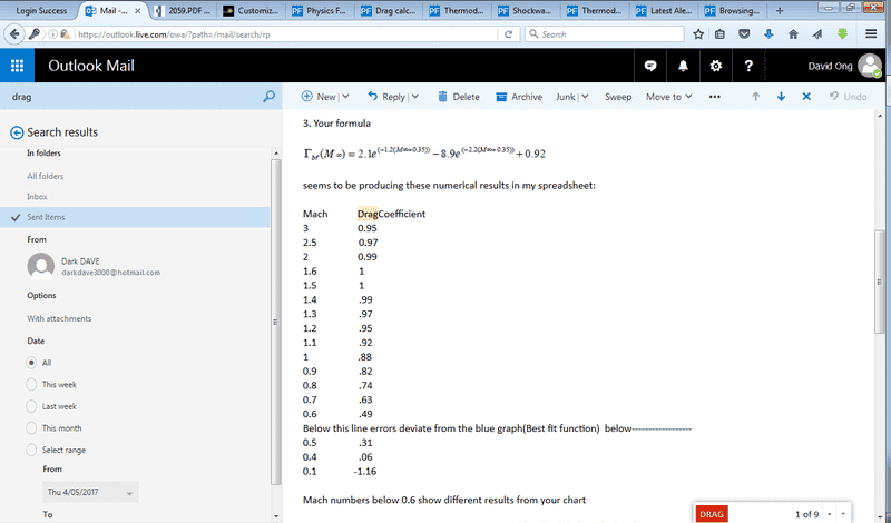

Can you confirm that the drag coefficient does not apply at supersonic speeds? I know that the drag coefficient will change at varying supersonic speeds, but youre now saying it does not apply at all? Or do you mean to just say that whatever Drag Coeficient I have for subsonic speeds is useless because they only apply to subsonic speeds?
Do you know of any formula that will predict the CHANGE IN DRAG COEFFICIENT at varying supersonic speeds?
Thanks for reminding me that air pressure and heat are related, I recall now in Chemistry about the gas laws.
I will look it up now because of this reminder. Perhaps I can use the force of drag for subsonic speeds to now calculate the average pressure on the air infront of the projectile to work out the total heat generated per unit time. Ofcourse this will only work for subsonic speeds however negligible the heat generated will be. I will then assume the heat generated remains in the air and figure out a way to predict how much of it from that fluid transfers to the skin of the projectile. Perhaps I need to read up on thermodynamics in general to find a relevant heat transfer formula.

There is, of course, drag force at supersonic speeds. It is just that the drag coefficient that you have for subsonic speeds cannot be used for supersonic speeds.
I found this paper that deals with the drag coefficients for meteorites traveling at hypersonic speeds. You will notice, however, that this paper does not discuss temperature. The temperature of the highly compressed air in the shock wave is the result of compression, not friction.
AM

Oh very nice! So I can continue to use the drag formula
https://en.wikipedia.org/wiki/Drag_equation
for supersonic speeds as long as I vary the Drag Coefficient in that formula accordingly to the supersonic speed it's at for that type of shape correct?
The paper you supplied gave some advice on how to change this Drag coefficient at various supersonic speeds.
Wikipedia does not state that the drag formula is only valid for subsonics. So can I assume it can be used for supersonic speeds as long as I alter the Drag coefficient as discussed above?

No. There is no formula. The paper I referred you to shows a relationship between mach no. and drag for a sphere. Use that. Again, this does not tell you what the temperature of the air or projectile will be.

The paper tells me how to alter the drag coefficient. Youre saying it also has its own formula for drag that is different than:
the above? So Drag Equation above is only for subsonic speeds? Or can I vary the drag coefficient as per paper for use with above drag formula? Wikipedia article above is valid only for subsonic? If so they should mention that and I will talk to wikipedia.
UPDATE:
re reading the paper you supplied confirms there is not drag equation, only equation to ALTER drag coefficient, so I still need a drag equation either the one mentioned above or otherwise. The output of such should be Force in Newtons due to drag.

This NASA article explains the drag coefficient reasonably well. Note, it says:
NASA article: The Drag Coefficient said:
At supersonic speeds, shock waves will be present in the flow field and we must be sure to account for the wave drag in the drag coefficient. So it is completely incorrect to measure a drag coefficient at some low speed (say 200 mph) and apply that drag coefficient at twice the speed of sound (approximately 1,400 mph, Mach = 2.0)."
The drag coefficient is used with the Drag Equation to determine the drag force. This is intended to be used for airplanes, not meteorites or re-entry spacecraft . The drag equation assumes a constant drag coefficient, which is not the case for supersonic and hypersonic (ie. extreme supersonic) speeds. For supersonic and hypersonic speeds for meteorites I would use the paper I referred you to.
UPDATE:
Yes. The paper deals with the drag coefficient, which I assume refers to the drag coefficient in the drag equation. You have to take the value for drag coefficient shown on the blue line on the graph on page 2 of the paper for a given speed and plug it into the drag equation to determine drag force on the meteorite. That will only give you the drag force at that speed. The drag force at a given speed gives you the rate of kinetic energy loss per unit distance traveled at that particular speed (this is different than the rate of energy loss per unit time) or the velocity loss per unit time. But, again, the rate of energy loss does not tell you what the temperature of the air in contact with the surface will be.

I wrote to some of the people who wrote that article you showed me , I haven't got a reply yet but could you have a look at this picture showing a portion of my email to them?
Here is the article again in case you need a quick reference:
http://www.lpi.usra.edu/meetings/lpsc2009/pdf/2059.pdf
Tell me what you think.
