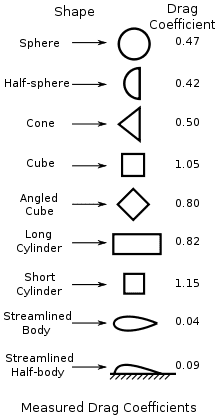

So... yeah I would just make it up. You can design a fake wind tunnel which might give realistic/intuitive results. Take these simple drags and when the mach number increases, increase the drag. So if you put 1 shape in, the game just increases the drag a set amount. If you have a weirdly shaped object, just count the number of squares and points for example. If it is a rough surface, make it turbulent flow. If it goes very high mach number, increase the drag a lot due to chemically reacting flow.
I think its your best bet.
