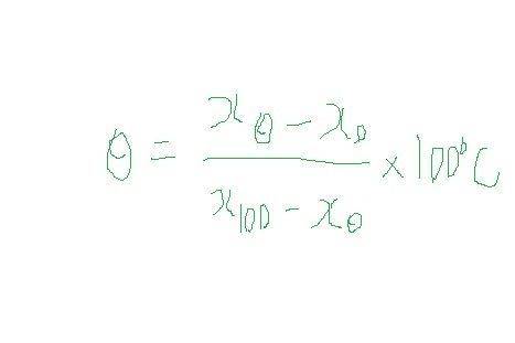

a constant volume gas thermometer was calibrated at the ice point and the steam point,. the thermometer was there used to measure the temperature of a beaker of hot water, the readings fro the height difference. h, between the mercury level in the closed limp and the open limp were - 50mm for ice point +220mm for steam point and +105 for the temperature of the hot water .
calculate the centigrade temperature of the hot water.
after applied all the data which was gave into the equation, 41.67 C, was the answer. what am i suppose to do after ? it is the right attempt in the first place?

based on the formula..
-50 - 0 / 100 - 220 * 100 C = 0.4167 * 100 = 41.67 C
( -50 is ice point, + 220 is steam point)
and a specific length is given for " temp of hot water" which is +105mm
therefore i doubt that 57.4 c = temp of hot water while +105mm wasnt used.

theta=((x at theta - x at 0)/(x at 100C - x at 0C))*100C...here x can be any physical quantity be it length of mercury column or whatever...now you substitute the required values of the physical quanties and you get your answer...

i do understand the fact that x can be any physical quantity, and that is exactly why i inserted -50 and +220 into the formula.
theta = (( -50 - 0) - ( +220 - * what goes here* )) * 100 c
dont you think it should be
theta= (x at theta -(-50))/(+220-0))*100...
where x at 0 C should be x at theta instead...
wait...are you referring to post no 8? That is correct because i was teaching you the thing there...No mistake there...the mistake is in post 10...
Abhishekdas said:
theta=((x at theta -(-50))/(+220-0))*100...
It should be ((x at theta -(-50)/(+220-x at zero))*100...
x at theta= 105 and x at zero as you know is -50...Try and understand this...and if you put in the vaules you get 57.4...i guess...
it makes a lot sense now.. but the equation states taht
theta = (( x at theta - x at 0)/ ( x at 100C - x at theta)) * 100 C
instead of
and according to you ... ( assumption)
x at theta = + 105mm
therefore theta = (( 105-50)/ ( 220- 105 )) * 100 C
theta = 47.8 C
