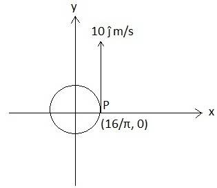

A train is moving counter-clockwise with a constant speed of 10 m/s in a circle of radius ##\frac {16} π## m. The plane of the circle lies in the x-y plane. At time t = 0, the train is at P, when a stone is thrown from it with a speed of 10 m/s relative to the train towards the negative ##x## axis at an angle of 37° with the vertical ##z## axis (assume g = 10 m/s2 and sin 37° = ##\frac 3 5##). Find:
(a) the velocity of the stone relative to the train at the highest point of its trajectory.
(b) the co-ordinates of the point where it finally falls.
(c) the co-ordinates of the point at the highest point of its trajectory.
Let vST be the velocity vector of the stone relative to the train.
vST = uST - gt##\hat k##
Also, position vector r = uSt - gt2##\hat k##
I know how to solve this problem, but there's just one hitch. The ##x## components of the velocity and co-ordinates they've given as the answer isn't matching with mine. Their answers are:
(a) (-6##\hat i## + 10##\hat j##) m/s
(b) (-4.5 m, 16 m, 0)
(c) (0.3 m, 8 m, 3.2 m)

Interesting , a 3D kinematics problems involving relative velocities. The whole catch of this exercise lies at this point
with a speed of 10 m/s relative to the train towards the negative x-axis at an angle of 37° with the vertical z axis
If I interpret this correctly I get that the initial velocity of the stone in the absolute reference frame has all three components ##(v_x,v_y,v_z)=(-6,10,8)##. And then the answer key for (a) seems wrong to me cause if we do the math correctly I think the train will be at the highest y point and having only x-axis velocity, at the time the stone reaches the highest point.
But in kinematics we don't care about the forces that cause the acceleration and velocity. We deal only with equations involving acceleration, velocity and position vectors. The centripetal acceleration and force at point P would be relevant only if we were asked to find the force that was applied to the stone to cause that relative velocity.
I think for this problem is better to work in the absolute reference frame, and when to find the relative velocities , we must find the velocity of the train at the requested time in the absolute reference frame.
Perhaps it's me but i interpreted "towards the negative X axis" as being to the left. The diagram appears to show it being thrown toward the positive y axis?
That's not the stone, that's the train velocity.

Yes, yes. My original attempt (when I felt that centripetal acceleration should be considered):
The initial velocity of the stone is uST = -6##\hat i## + 10##\hat j## + 8##\hat k##
Acp = vT2/ro → ro is the radius.
Acp = ##\frac {100} {16/π}## = ##\frac {25π} 4## m.
a = ##{\frac {-25π} 4}{\hat i} - 10\hat k##
(a) vST = uST + at
The particle will be at its highest point of trajectory when the ##z## component of velocity becomes 0 (the ##x## component won't become 0 because ax ∥ uST-x)
Hence, 8 -10t = 0 ⇒ t = ##\frac 4 5## s. Therefore, the total time of flight T = ##\frac 8 5## s.
vST = (-6 - 5π)##\hat i## + 10##\hat j##
(b) r - ro = uSTt + ##\frac 1 2##at2
Substituting with T = ##\frac 8 5## s,
r - ##\frac {16} π \hat i## = ##(\frac {-48} 5 - 8π)\hat i + 16\hat j##
r = ##(\frac {16} π - \frac {48} 5 - 8π)\hat i + 16\hat j##
(c) Substituting with t = ##\frac 4 5## s,
r = ##(\frac {16} π - \frac {24} 5 - 2π)\hat i + 8\hat j + \frac {16} 5 \hat k##

The given solution to a is not relative to the train, but is correct relative to the stationary coordinates. Either the didn’t mean to say “relative to the train” or the answer is wrong.
baldbrain said:
vST = (-6 - 5π)^ii^\hat i + 10^jj^\hat j
You were doing well to here. Where did the 5 pi come from?
So should it be -6##\hat i## + 10##\hat j## -(-10##\hat i##) ,i.e., (4##\hat i## + 10##\hat j##) m/s?
Since the velocity of the train would have become -10##\hat i## m/s.
As I said, my original attempt taking the Acp into account.
Yes.
It would be if the train was still at the same place it was when the stone launched. (But it isn’t)
No, it is correct. The train has traveled to the y-axis and is moving in the negative y-direction, which he correctly used.
I stand corrected. I glanced and ass-u-me-d. Should have looked closer.
You mean in the negative x-direction (that's where the instantaneous velocity of the trains lies , when the train is at the top point of the circular orbit).
Yes, early morning.
