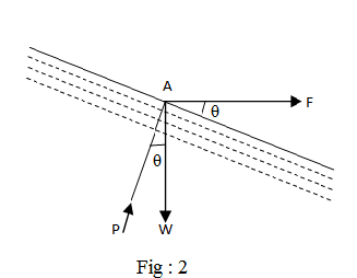

You mean something like that? where F should be replaced by the centripetal acceleration and P should be replaced by the gravitational acceleration?
Free-body diagram of a block at point A on an inclined plane, with forces F horizontal to the right, W vertically down, and P along the normal, angle theta marked between the incline and horizontal, and between P and the vertical.
Tan θ has a direct relation to height y upon distance x ( Tan θ = y/x ) , not to the accelerations .
Fig 2: Free-body diagram of a point A on an inclined surface with force F pointing right, weight W pointing down, and force P at an angle, with angle theta marked between the surface and horizontal and between P and vertical.
No.

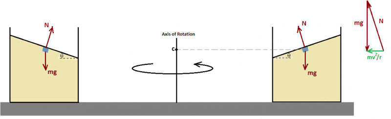

I think I’ve caused confusion by trying to approach the problem using the idea of an “effective acceleration of gravity”. I thought that was maybe the way you were approaching the problem in your first post.
Instead, we can go back to basics and apply Newton’s laws in the inertial frame of the earth. Consider a small chunk of water at the surface as shown in the diagram below. The chunk moves in uniform circular motion where the center of the circle, C, lies on the axis of rotation of the turntable.
There are two forces acting on the chunk: gravity (mg) and a normal force (N) that is due to the water surrounding the chunk. The net force acting on the chunk is the vector sum of these two forces, which is shown as the green vector in the figure at the far right. The net force must point towards C and it must have a magnitude ##mv^2/r##.
Try to use this force diagram to determine the angle ##\theta## that the surface of the water makes to the horizontal.
  • Free-body and force diagram of a water chunk on a rotating turntable: two side views of tilted water surfaces with normal force N and weight mg, a central axis of rotation, and a vector triangle showing mg, N and mv^2/r.

Thank you guys so much! Especially for the illustartion.
