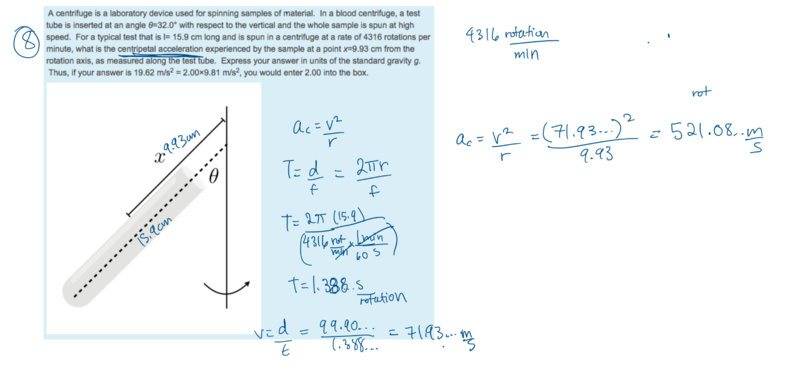

A centrifuge is a laboratory device used for spinning samples of material. In a blood centrifuge, a test tube is inserted at an angle θ=32.0° with respect to the vertical and the whole sample is spun at high speed. For a typical test that is l= 15.9 cm long and is spun in a centrifuge at a rate of 4316 rotations per minute, what is the centripetal acceleration experienced by the sample at a point x=9.93 cm from the rotation axis, as measured along the test tube? Express your answer in units of the standard gravity g. Thus, if your answer is 19.62 m/s2 = 2.00×9.81 m/s2, you would enter 2.00 into the box.
a=v2/r
T=2πr/f
v=d/t
First, I found the period
T=2π(15.9)/(4316/60)=1.3888
v=2π(9.93)/1.3888=71.9
a=(71.9)2/9.93
I don't think I did this correctly, as I didnt use the angle...
I have included a photo as well,

Jpyhsics said:
a=v2/r
T=2πr/f
v=d/t
The equation T=2πr/f cannot be correct as you can tell by doing a unit analysis of the equation.
3. The Attempt at a Solution
a=(71.9)2/9.93
You need to be clear on the meaning of r in the equations. You want the centripetal acceleration of a particular point in the test tube. Mark this point in your diagram and try to draw a representation of r in the diagram.

Jpyhsics said:
but what about the period (T)?
If the test tube makes 4316 revolutions in one minute, how much time does it take for it to make one revolution?
0.0139s per rotation?
Oh I see how the angle relates now. I got an answer of 10749 m/s2. Thank you so much for your help! :)
I think your answer is correct. Good work.
