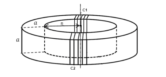

I have a toroid with square cross section and 2 different circuit:
##C_1## where ##N=N_1## and ##I=I_1##
##C_2## where ##N=N_2## and ##I=I_2##
I have a question that say I have to find the magnetic field ##B## produce by ##C_1## everywhere inside the coil. I assume here I have to find the magnetic field ##B## produce by ##C_1## everywhere inside the toroid.
I'm wondering if ##C_2## can affect the magnetic field caused by ##C_1## and I'm not sure how it works for a coil only around a little part on the toroid.
For exemple, If I have only a coil around the entire toroid, I can find the magnetic field using the Ampere's law.
##\oint B \cdot dl = \mu_0 NI##
##dl = 2\pi r##
##B = \frac{\mu_0 NI}{2\pi r}##
The modified form of ampere's law for this configuration correctly reads ## \oint H \cdot dl=\sum N_i I_i ## .
Do they give the magnetic permeability ## \mu ## of the core material? (where ## B=\mu H=\mu_o \mu_r H ##).
The question they are asking appears to be somewhat incomplete.

I have this statement in the question. The magnetic field inside the toroid is only affected by the distance from the center of the toroid. I think for this question I don't have to deal with the material but only with the shape of the toroid and the coils. In this case ##B## = ##H## ?
Thus,
## \oint B \cdot dl= N_1 I_1 + N_2 I_2##
##B = \frac{N_1 I_1 + N_2 I_2}{2\pi r}##
However, is that the magnetic field produce by ##C_1##?
If it is air or vacuum, (perhaps it is), then ## B=\mu_o H ##, but for that case, you don't get a nearly uniform flux that goes around the entire toroid for a given ## r ##. It does appear they may not have given complete information. I'm also puzzled about ## C_2 ##. In general, ## C_2 ## will also contribute to the ## B ## field, but it is really a poorly stated problem to ask for the ## B ## due to ## C_1 ##. They would do better to ask for the ## B ## given ## C_1 ## and ## C_2 ##, and it is really important to have a ferromagnetic material for the core, unless the windings themselves cover the whole toroid.
They also should specify the direction that the windings are wrapped relative to each other.
It is a good introductory problem that leads into the operation of a transformer in the ac case, but they would do well to give more complete information.
I guess the material is ferromagnetic since we didn't work with anything else until now.
Even if the coil is only over a small area of the toroid I have to use the Ampere's law as if it was around the entire toroid, right?
As Chas. Link says, the B field depends on the permeability of the core.
You can use Ampere's law as you stated it for H, however.

Yes. That's how it works for ferromagnetic materials=the lines of flux follow the material and the ## H ## and/or ##B ## are very nearly the same all the way around. That would not happen that way if it was air. For the mathematics, the formula reads ## \oint H \cdot dl =\sum N_i I_i ##. First the ## H ## is computed, and then you compute ## B ##. This formula is a modified form of ampere's law, and it is based upon some very exact physics. There is always the possibility that the ## H ## in the integral will be non-uniform, but for materials like an iron toroid, the ## H ## is found to be nearly uniform around the toroid, even if just a couple of windings are made in a very small section of the toroid. The ## H ## is simply a function of ## NI ##, and it doesn't matter whether the ## N ## windings are done in a small section or spread out around the entire toroid.

With all that, I have new questions, but I can't find any example of a toroid with 2 coils.
I'm wondering if I should consider the entire toroid to get the self inductance.##\phi_{11} = L_1I_1##
##B_1 = \frac{\mu_0 N_1 I_1}{2\pi r} = \mu_0n_1 I_1##
##\phi_{11} = B_1 \int \int ds = B_1a^2## for a square cross section ##l=a##
##\phi_{11} = \mu_0 n_1I_1a^2 (n_1l_1)## for a coil
##L_1 = \mu_0n_1^2a^2 l## = ##L_1 = \mu_0n_1^2a^2 (2\pi r)##
Is ##2\pi r = l## is correct?
To get the self-inductance, you need to multiply ## B A ## by the number of turns ## N ## to get the flux links in the circuit. Note: ## \mathcal{E}=-\frac{d \Phi}{dt}=-L \frac{dI}{dt} ##. Here ## \Phi =NBA ## is the flux "links."
## 2 \pi r=l ## is correct.
For a toroid with two coils, the flux from each will either add or subtract, depending on whether they are wound the same or not.
