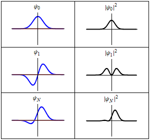

If we talk about the wavefunction and different states; I think it's obvious that an 'undisturbed' stationary state, that passes through a wide enough slit, generates a 'fixed' probability density. While a 'disturbed' superposition state ('squeezed' through the slit) generates a 'wobbling' probability density, hence greater uncertainty.
Top two rows are stationary and bottom is superposition

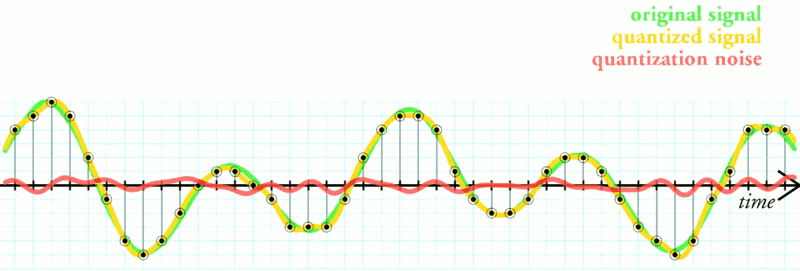

Talking macroscopic: Phase & frequency for a wave in the time domain is analogous to position & momentum for a wave* in the spatial domain, right?
Question: How do you measure the exact pitch for a sound wave in an exact moment in time?
