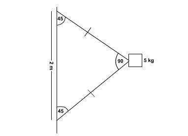

A mass of 5 kg is tied to two strings of equal length, which are attached to a vertical pole at points 2.o m apart. As the pole rotates about its axis, the strings make a right angle with each other. Also, the mass makes 2 revolutions per second.
a) the tension in each string
b) the speed of revolution that makes the lower string go slack
F net = F c ( Centripetal force)
I calculated the total centripal force acting on the mass.
FNET = Fc
Fc = mv^2 / r = m ( 2pi r (revolutions) ) ^2 / R
Fc = 790
I know that the FNETy = 0 because the object is always forming that angle and is constant at it.
Therefore, Force in the y direction on the mass = the total of the forces in the y direction for both the strings and of the mass.
I came up with the equation,
0 = T1 ( top string) SIN 45 - T2 ( bottom string) SIN 45 - MG
0 = T1 ( top string) SIN 45 - T2 ( bottom string) SIN 45 - 10 (5)
0 = T1 ( top string) SIN 45 - T2 ( bottom string) SIN 45 - 50
I do not know how to get the forces in the x direction for the strings.
Please help.
  • Diagram of a 5 kg mass hanging from two equal-length strings attached to a vertical pole 2 m apart, with the strings meeting at a right angle and each making 45 degrees with the pole.
  • Diagram of a 5 kg mass hung from two strings attached to a vertical wall, each string at 45 degrees to the wall, with a 90 degree angle between them. Labels show Fc = 790 N, Fg = mg = 50 N, and angles 45, 45, 45, 90.
if the net force in the y direction is zero, which component of the strings' forces provides the centripetal acceleration?

i would suggest drawing free-body diagrams of all the objects involved.
ok do you want me to draw them and attach them to the image
so you want to see a FBD of the mass
actually i can't see your image...but it should help you to understand the forces at work.
it is a JPG image
i have put a new one
which might help you understand better
i forgot to mention in the picture, that the distance betweeen the two strings on the pole, sorry not wall as i wrote on the picture is 2 m
actually they need to be approved before we can see them. i understand the problem fine, and can draw the picture as well. I'm just asking if you have labeled all of the forces at work on the strings and the mass.

you seem to have the right idea in your drawings. if you look at the forces on the strings, you see that they are the tension which causes the Acent for the object, and the tension which keeps the object from falling due to gravity. therefore the total force on both strings needs to nullify these two other forces.

here's a hint: what should the tension in the X and Y directions on each string be, since the angle is 45 degrees?

well the y components of the tension are in opposite directions and yet add up to Fg
what about the x components?
no no
look at the picture
the y component of tension in the upper string ( US Y ) equals
the y component of tension in the lower sting ( LS Y ) and the force pulling the weight down which is mg which is 50 N
US Y = LS Y + 50 N
if you give each of these signs describing up/down, you have:
Fg+US Y+LS Y=0
the LS is negative, as is Fg, while US is positive. US plus LS are equal and opposite to Fg

that doesn't mean they are the same. the mass pulls more on the top string because the mass is below it, so the top string fights gravity and the lower string in the y direction. the x and y of both strings are ___?
