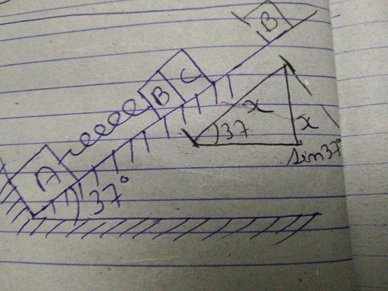

See question number 1.
Work Energy Theorem,
work done by all the forces=change in K.E.
I tried solving this question this way,
please help me calculate the Work Done by spring here??
I will be thankful for any help!

It might be simpler to start from the final situation. When A just loses contact, what is the tension in the spring?
(In future, please use thread titles that indicate the topic.)
It would be,
-0.6x=1*10*sin(37)
So what's next?
navneet9431 said:
It would be,
-0.6x=1*10*sin(37)
So what's next?
Actually I asked for the tension, but you went a step further and found the extension.
So what is the total energy in the system at that point?
It would be zero,Right?

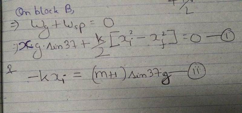

I tried solving it this way this time...,
I have formed two equations,
Are these two equations useful in finding "m"?
Or,do I need to find something more?
I will be thankful for help!
In eqn (1),your first term is missing a factor. It does not appear to have the dimension of energy.
What is the relationship between the x on the left and xi and xj on the right?
In eqn (2), you seem to have "mH" (or m+1?), but I do not know what this is supposed to be. And are you sure about that minus sign?
In the first equation W_gravity on B=1*x*g*sin(37),is it correct now?
And in equation 2
It's not "mH",It's (m+1)[sorry!For my poor handwriting]
Yes I think there would be a minus sign because the formula for spring force is "-k*x".
Is it correct?
And in equation 2
Ok, you fooled me in both because you left out the units. When you use a symbol like m for mass you do not need to state units because m has dimension, but when you plug in a specific value like 1kg that's what you must write, 1kg, not just "1".
That's fine if you are taking xi as negative.
But you did not answer my other question: what is the relationship between the xi and xj you have in the second equation and the x you have in the first equation?
The relation between xi, xj and x would be "xi+xj=x".
Please tell how to proceed further!
