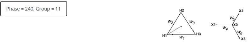

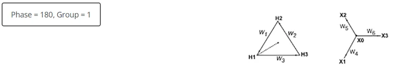

Can someone please explain the phase angle and group of these two Dy transformer diagrams?
On behalf of someone on another forum; In both cases, he’s been given the answer, but doesn’t understand it:
To me, the group does make sense in both cases, if you imagine the diagrams rotating anticlockwise: the vector X1 lags by 30° in the first case, giving 11 o’clock as the group, and leads by 30° in the second, giving 1 o’clock.
I’m stumped by the phase, as he is. I think it might be to do with the fact that the top delta is clockwise, and the bottom the opposite.

Guineafowl said:
This is group 1. If H1 points at 12 o'clock, X1 will point at 1 o'clock.
Guineafowl said:
This is group 11. If H1 points at 12 o'clock, X1 will point at 11 o'clock.

Thanks, so by that definition the group 1 will be a 30°, and the group 11 a 330°?

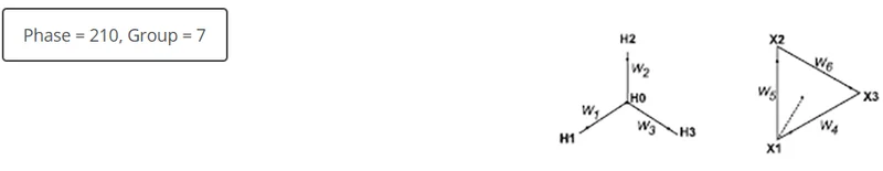

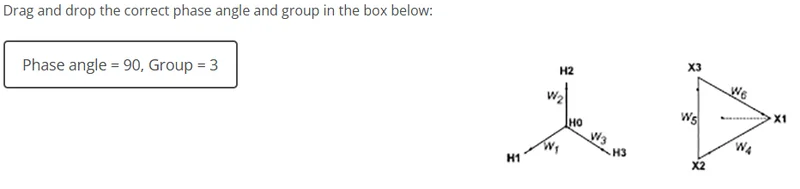

There were two other examples:
I make these group 7 and 11 respectively, so I were all four examples wrong?
The only other point is, for the two examples above, the vector X1 is pointing at the non-dot end of W4 in the first, and at the dot end in the second. Is that a mistake too?
Reply
Yes, you are right. That means X1 lags H1 by 30° in group 1, and X1 lags H1 by 330° in group 11.
