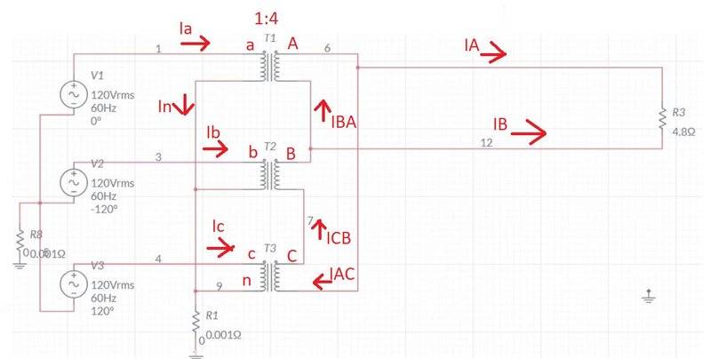

BuzzBar
Three wye-delta (120:480) is feeding single phase load as per diagram. How will current be distributed in the delta winding when single phase is connected between line A and B ?
When I solve by hand I get different results when simulating in Multisim.

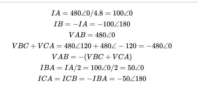

Hand calculation - Winding A will be in parallel with winding B&C (which are in series and B+C=-A). This will cause the current to be split evenly between windings A (50A) and B&C (50A).

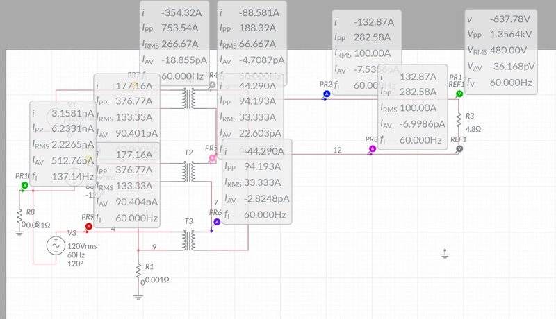

However when I use Multisim currents are winding A (66A) and B&C(33A).
Which calculation is correct? I don't understand how Multsim is solving winding A to carry double the current in winding B&C,

Is this for schoolwork? If so, I can move it to the schoolwork forums for you. Also, can you clarify on your diagram which are "line" A/B/C and "winding" A/B/C? Thanks.

Hi, yes its is for school. I added line and winding currents designation to the diagram.

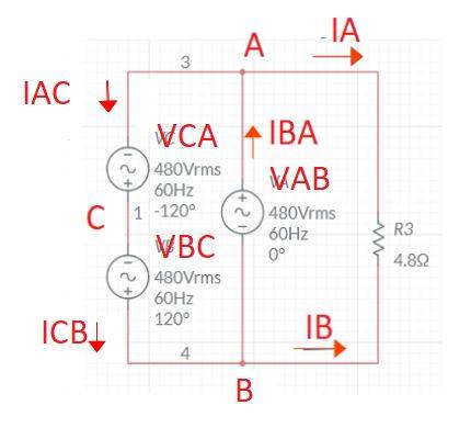

Hi, I rearranged the delta circuit and treat each winding as as voltage source. I use VAB for reference and consider it to be at angle 0. When I add VBC and VCA as vector sum I get them to be equal to -VAB. So from this I have two equal voltage sources, so current should be dived equally between two voltage source branches,

The circuit is overdefined by having three voltage sources, with a closed delta that must sum to zero. Something must give.
The voltage of the delta secondary, relative to ground is floating, unspecified.
You have two voltage sources across a single load. One has double the source impedance of the other unless otherwise defined. It should be clear after stating that assumption.
It is obvious that Multisim has used the equation ## I_{AC}+I_{CB}+ I_{BA} = 0A ## instead of ## I_{BA} = \frac{I_{A}}{2} ## has been used by @BuzzBar.
The system is unbalanced and in my opinion the Multisim approach is wrong.
