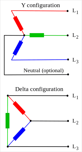

WyeDelta.png image:
Two circuit diagrams: a Y configuration with resistors meeting at a central node, and a Delta configuration with resistors forming a closed triangle; each has three lines labelled L1, L2, L3, and the Y version shows an optional neutral line.

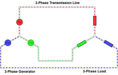

3-phase_flow.gif image:
Schematic of a three-phase electrical system: three colored sine-wave sources (red, blue, green) on the left as the generator, connected by wires to three loads on the right, with the transmission line shown in red across the top.

  1. The three lines can be connected in a Wye / Y configuration or in a Delta / Δ configuration, like shown in the WyeDelta.png image.: (There can optionally be a fourth line that's neutral in a Wye / Y configuration.)

  • Two circuit diagrams: a Y configuration with resistors meeting at a central node, and a Delta configuration with resistors forming a closed triangle; each has three lines labelled L1, L2, L3, and the Y version shows an optional neutral line.
  • Schematic of a three-phase electrical system: three colored sine-wave sources (red, blue, green) on the left as the generator, connected by wires to three loads on the right, with the transmission line shown in red across the top.

The generator in your diagram is a just a model for understanding three-phase generation. Practical generators are constructed differently.
s3a said:
Are the three coils that surround the magnet (for example, as in the image Three-phaseElectricPower.jpeg) or are surrounded by the two magnets inductors (as I've seen in another source)?
The rotating bar magnet is surrounded by the three coils (electromagnets).
s3a said:
If the coils that surround the magnet or are surrounded by the two magnets are in fact inductors, then are their impedances just ignored because of it not mattering due to voltage sources delivering the "promised" voltage anyways? In other words, do the impedances in the 3-phase_flow.gif image only represent the impedance that is not present at the site of the electromagnetic induction / magnetic induction?
The flux from the rotating bar magnet which links with the coils produces emf. The current depends on the load impedance, the leakage reactance of the coils and the synchronous reactance of the machine (assuming zero resistance in the conductors). Synchronous reactance is a bit difficult to explain. We can get back to that later if you want.
s3a said:
How does the generator start? Do the three power sources start the rotation of the magnet or does the rotation of the magnet start the power providing of the power sources? Or, what else?
Any generator is started and run by providing external mechanical input. The sole purpose of a generator is to convert mechanical energy into electrical energy.
In power stations, this mechanical input (torque) is derived from coal, hydro, nuclear energies.
