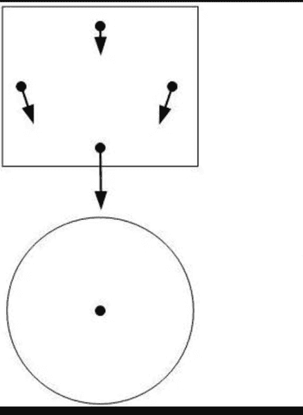

I meant separated horizontally. So the left and right ones in the diagram, not the top and bottom ones.
Yeah, I understand that it is from potential energy. But in the classical case, the energy is stored by a force from within the system.
If I consider the two masses and the spring in between as an isolated system while excluding everything else, we see the spring compress, yet something external should be doing work on the system.
Ah, ok.
No, you won't, because excluding everything else means excluding the Earth and its tidal gravity. In the presence of tidal gravity, the masses and the spring are not an "isolated system" any more, and reasoning as if they were will give wrong answers.
