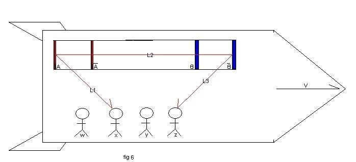

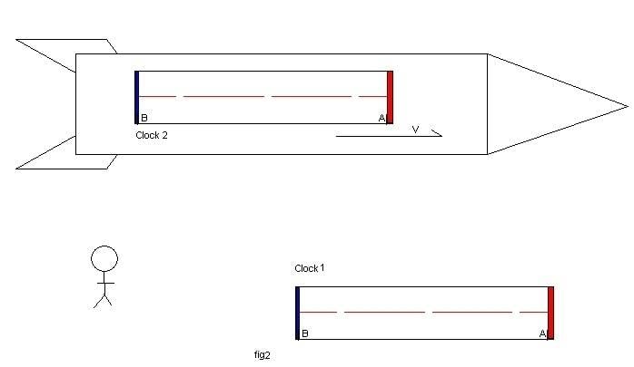

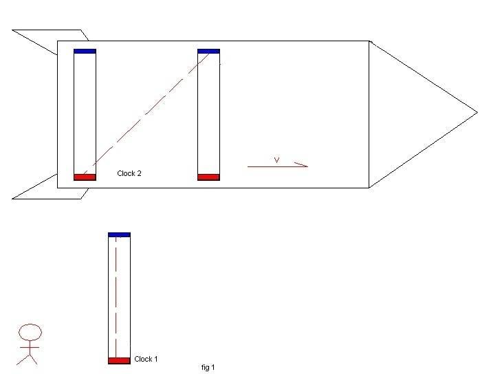

Can someone please have a look at my analysis here and tell me if there are any mistakes
the rest of the pistures are in my other posts
___________________________________________________________________________
Einstein’s explanation of time dilation is given here http://en.wikipedia.org/wiki/Time_dilation
Referring to fig 1
In Einstein’s explanation you have 2 identical clocks. Clock 1 is at rest wrt the observer. Clock 2 is in a spaceship zooming along wrt the observer.
At the red end of the clock is a light source, at the blue end a detector.
If L is the length of the clock. The observer, observing the clock at rest wrt him would see that the light pulse would take L/c time to traverse the length of the clock.
Einstein postulated that as the observer would see the photons in clock 2 travel a longer path to move from the red end to the blue end when compared with length of the path the photons in the clock 1. Therefore clock 2 must tick slower (time passes slower) when compared to clock1.
Referring to fig 2
As in Einstein’s explanation again you have 2 identical clocks. Clock 1 and clock 2 are at rest wrt the observer. This is the trivial case. Again at the red end of each clock is a light source, at the blue end a detector.
If L is the length of the clock. The observer, observing both clocks would see that the light pulse would take L/c time to traverse the length of the clock.

Referring to fig 6
I have a clock in the space ship.
The spaceship is flying at constant velocity V.
As the speed is constant the contraction is constant and the time rate is constant.
The observer, point A and point B form an isosceles triangle.
The length of the clock is L which equals the length from B to the observer and also A to the observer.
I note the clock in fig 6 is rotated 180 degrees wrt the clock in fig 5 the red and blue ends have changed.
I NOTE THE DRAWING IS NOT TO SCALE.
At some initial time the ends of the clock will be located at points A and B. At some time in the future as the spaceship is moving the ends of the clock will be located at points A hat and B hat.
At t0 a pulse of light leaves the red end of the clock. The pulse simultaneously heads towards the blue end of the clock and towards the observer. Also at t0 the observer is located at point W.
By the time the pulse from the red end of the clock reaches the observer he will be located at point x.
When the pulse reaches the blue end of the clock the observer is located at point y. The pulse of light bounces of the blue end and now heads in the direction of the observer.
By the time the pulse from the blue end reaches the observer the observer will be located at point z.
Analysis
Referring to fig 7
Using the cosine rule L1 can be calculated.
Times will be proportional to lengths as time is simply length/c
Angle g = 60 degrees
Angle e = 120 degrees
Cos 60 = 0.5
Cos 120 = -0.5
L1^2 = L^2 + (Vt1)^2 – LV(t1)Cos(120)
L1 = sqrt(L^2 + (Vt1)^2 – LV(t1)Cos(120) )
t1 is the time it takes for the pulse of light to travel from point A to point x
Referring to fig 8
Using the cosine rule L3 can be calculated.
Angle e = 60 degrees
Cos 60 = 0.5
L3^2 = L^2 + (Vt2)^2 – LV(t2)Cos(60)
L3 = sqrt(L^2 + (Vt2)^2 – LV(t2)Cos(60) )
t2 is the time it takes for the pulse of light to travel from point B hat to point z
from fig 6
L2 = L + V(t3)
t3 is the time it takes for the pulse of light to travel from point A to point B hat.
The time difference the observer will see between the first pulse of light he sees and the second is:
Time_Diff2 = (L1 – (L2 + L3))/c
L2 = L + V(t3)

Rab99:
I tried to read your first post and stopped when I came to this
The time the photons in clock2 would take would be at most
T = L/(c + V)
As clock2 is moving its length would be contracted and the time taken would actually be less than L/(c + V).
This made me unhappy because c+V implies something moving faster than light-speed, which I can't accept.
I skipped to the end and found
As all frames of ref are completely contained within a larger frame I note for any observer, unless they are in the absolute frame of ref, Time_Diff1 will not equal Time_Diff2 as they will have some residual velocity due to the velocity of the larger containing frame of ref.
What is the absolute frame within which all frames are contained ?
This analysis demonstrates that an experiment can be performed in a moving frame of reference to show the observer at rest with that frame of ref that they are in a moving frame of ref.
I don't believe this. I am convinced that this "it is not possible to distinguish a state of rest from a state of uniform motion" is true.
Take me for instance, sitting in front of my computer in a room on earth. Assuming there are observers around the cosmos on other planets or spaceships, they will each see me in a different state of motion. I don't have an 'absolute state of motion', only relative states of motion.
Hi rab, I am not even sure this apparatus is a clock. Usually a clock has some sort of recurring event at one location in its rest frame, this doesn't. How would you use this to time something?
Usually a light clock has a mirror on one side and then the emitter and detector on the same side. That way you are measuring the time between two events (emission and detection) at the same location in it's rest frame.
Referring to fig 1
Remember that two different frames can only agree on the length of the clock if the clock is oriented at right angles to the two frames' relative motion. So in the setup of your first diagram they'll both agree on the length, but in the setup of your second diagram, if the clock's length is L in the ship's rest frame then it will be only L*\sqrt{1 - v^2/c^2} in the frame where the ship is moving forward at speed c.
rab99 said:
Referring to fig 2
Usually in this thought-experiment we talk about the time for the light to go from one end to the other and back, in which case the time would be 2L/c for the observer on the ship.

rab99 said:
this does have two events.
Yes, but the interval between the two events is lightlike, not timelike. This means that there does not exist any frame where the events measure two points in time at a single point in space. The interval between two clock tick events needs to be timelike.
No this was not a postulate, this is one of the consequences of two postulates.

Yes you keep using frame of reference but you have yet to define what observers are actually moving differently from the other observers and clocks. You appear to assume that the frame of reference is different just because they aren't in the same place.
In my anaylsis of fig 5 and fig 6 I am purely concerned with what the guy in the spaceship sees and he is at rest wrt the clock he is observing. I am not interested in any other frame. Just the guy in the spaceship observing the clock in the spaceship and a mathematical analysis of what he sees.
With the clock in one oreintation he sees two flashes of light separated by a time delay
With the clock rotated by 180 degrees he sees two flashes of light separated by a time delay that is not the same as the first time delay...how difficult can it be?
the weirdness lies in the fact that time delay one is not equal to time delay two ...why not?
no one has given me an answer much less a satisfactory answer yet
That's what I thought. Then there is absolutely nothing moving and V=0 in all cases. Defining V as anything but 0 is not valid and doing so you must "concern" another observer outside the spaceship.
It does always equal as I have restated several times. The mistake is giving a velocity when in fact there is no velocity between any of the clocks or observers.
1. the guy in the spaceship may not be aware of it but the reality is at time 1 he will be at a position say position 1 and some time in the future he will be at a different position ..is that agreed?
Velocity = distance over time
2. But photons are completely separate from the frame they always travel at C regardless of the direction or velocity of the frame. Photons are not ballistic. The photon at time 1 will be at a position and at some time in the future guess what its in a diff position.
if you agree statement 1 then you also must agree there is a velocity..there is a change in position and there is a time differential. The guy in the spaceship is not aware of this velocity but none the less he has a velocity and his velocity is completely disconnected from the velocity of the photon in the space ship. The two move independently. The photon has no intelligence and doesn't know its in a moving frame of ref.
we now have two velocities the veocity of the photon and the velocity of the clock and the observer. If you agree statement 1 then you must agree with my analysis. if you agree statement 1 but not my analysis how?
If you don't agree statement 1 then how?
No! He is at the same place. The rest of the Universe moved. You cannot under any circumstances tell the difference.
How what? How does he have a velocity? He don't. How does his vector have a direction? It don't. The rest of the Universe does.
