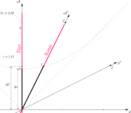

After i figured out how to show length contraction in this topic. I tried to use a similar way to show time dilation in Minkowski diagram. Time dilation means that time interval between two events is the shortest in the frame in which those two events happen in same place. We call this frame its rest frame.
According to just said I set up my problem so that frame x,ct is my rest frame as edges of a time interval \Delta t happen on a same vertical line. This means that time interval \Delta t should be the shortest time interval compared to time intervals in any other frames. Including frame x',ct'.
But when i draw time interval \Delta t' it is obvious that it is shorter than interval \Delta t. So why do i get time contraction instead time dilation?
Marks 1' and 2' on ct' axis are further appart than marks 1 and 2 on ct axis (i even draw a parabola to show this). This is why \Delta t = 1 and \Delta t' < 1'.
http://shrani.si/f/v/F4/2Fo9hrOu/avezo-1.png
Are you getting mixed up by the term "time dilation" which mean seconds on a moving clock according to an Inertial Reference Frame take longer than the coordinate seconds of the IRF which means the moving clock advances by a smaller amount of time than the coordinate time?
Your ##\Delta t'## should go all the way up to point ##1'##. That is the time we're talking about when we talk about time dilation: it captures how we, in the unprimed frame, measure the time elapsed between an event at the origin and point ##1'##.

So is my picture correct?
It's not. ##\Delta t'## needs to extend all the way up to ##1'##. For a given invariant interval, the time portion of that interval is shortest in the rest frame. But the way you've drawn it, the black portions do not have the same invariant length, so you get an erroneous result.

If i understand this then first i have to extend \Delta t' all the way up to 1'. Secondly if i want to know how observer in rest frame sees this interval i have to project it to ct axis? There i will see that projection is actually longer than \Delta t .
Please correct me if i am wrong.
You seem to have overlooked that the scale on the t' axis is different from the scale on the t axis. Check out section 1.7 in Schutz.
Edit: I wrote this before I saw the last two posts above.
No. The two invariant intervals must be the same length, and you measure the times from those intervals (you don't adjust the times to be the same, which is what you just suggested). The time we measure for the two intervals in the unprimed frame is just the projection of those intervals on the ##ct## axis.
You correctly drew the hyperbola and saw that ##1'## must lie on that hyperbola. ##\Delta t'## goes up to ##1'##. ##\Delta t## goes up to ##1##. From each point, you draw a horizontal line over to the ##ct## axis, and those are the times those intervals span.

But here i am not dealing with length contraction, i am dealing with time dilation. I measure time on a same vertical line or line parallel to ct' axe.
The interval you've labeled as ##\Delta t'## is the the time between the origin and ##1'## according to the ##S## frame, not the ##S'## frame. With the situation you have--an active transformation--this is the correct time to look at to see the effect of time dilation, but you've drawn the wrong conclusion about what time it represents. The set of axes you use to determine the coordinates determine which frame you're measuring with respect to.

OK i hope now i get it... But to be sure i am not doing it wrong again i will list steps which bring me to the conclusion. Please take a look at steps below and if anyone among those steps is wrong please tell me.
STEP 1: I draw both coordinate frames. First i draw frame x,ct and then by using hyperbola i draw x'ct'. I allso draw points 1, 2..., 1', 2'.... Now i make a conclusion and i say: "Because i constructed frame x',ct' by using frame x,ct all the distances in a frame x',ct' are already represented as observer in x,ct sees them. I think this is what you ment with "active transformation".
http://shrani.si/f/1w/N0/ES721h2/minkowsky-diagram10.png
STEP 2: I add (in the picuture) a time interval \Delta t which is an interval between 2 clock ticks for a stationary observer in frame x,ct. \Delta t must lie on a vertical lines as 2 clock ticks aren't moving in respect to observer in x,ct.
http://shrani.si/f/s/oW/1IzLR4kj/path3920-51-3.png
STEP 3: I project \Delta t to the ct' axis using hyperbola and i get a length from origin to 1' which represents \Delta t' (BUT as observer in a frame x,ct sees it!).
http://shrani.si/f/R/Wl/3IgVyisj/minkowsky-diagram10.png
STEP 4: Just for better comparrison i transfer \Delta t' to the ct axis using normal rotation.
http://shrani.si/f/2A/I1/4EjyDWjm/minkowsky-diagram10.png
STEP 5: I conclude, that \Delta t' > \Delta t and so i have a proof for time dilation.
Step 1: there should be no 2' on the x' axis. The curve you're using is a hyperbola, not a parabola. By "active" transformation, I mean you're actually remapping the points ##1,2## to ##1',2'##, and ultimately, you will resolve the components of these primed points with respect to the unprimed (##S##) frame. In fact, you need not draw the ##x', ct'## axes at all, but it does make things clearer.
Step 2: this is correct.
Step 3: I think this is the big issue. To me, it's not clear if you mean to measure the interval between the origin and ##1'## with ##\Delta t'## here or what. There is an interval here, but it doesn't make sense to call this black line ##\Delta t'## and then claim to measure this interval along the axis (which is what you end up doing in step 4).
Step 4: No, there should be no ordinary rotation here. I drew an analogy to ordinary rotation to try to get you to think about how that entirely different problem would be done. All you should do is draw the horizontal line from ##1'## to the ##ct## axis.
My advice to you, to try to make this as unambiguously clear as possible, is to do the following: forget trying to use deltas. Just look at the coordinates. Don't draw the ##x', ct'## axes. The hyperbola is enough to get a sense of where ##1'## is. Simply draw perpendiculars from the ##x, ct## axes to ##1'##, and this tells you the coordinates of ##1'## in the ##S## frame. The time coordinate of ##1'## will be larger (15% larger, by the math you've done) than the time coordinate of ##1##.

Take a look again at below picture. Can you confirm now that it is correct. ##\Delta t'## is the time component you are talking about.

71GA, can you explain one thing...what is ##\Delta t'## supposed to be? I mean, I can only calculate it if I know its definition, so how do you define it?
If you want to calculate it you can use equation (##m## is a unit of meter):
<br /> \begin{split}<br /> \Delta t&#039; &amp;=\gamma \Delta t \\<br /> c\Delta t&#039; &amp;= \gamma \, c \Delta t \\<br /> c \Delta t&#039; &amp;= \gamma \,1m \\<br /> c \Delta t&#039; &amp;= 1,15\, 1m \\<br /> c \Delta t&#039; &amp;= 1,15m<br /> \end{split}<br />
But this is not about equation at all. It is about a graphicall image which can help reader to see things and clear them up.
He didn't want a formula, just an explanation about what it represents, I think. This has been some point of confusion throughout the thread. I tried to clear it up by saying that ##\Delta t'## should be the time coordinate of ##1'## in the ##S## frame.
I think the last picture is valid, so you should be able to see what's going on now.

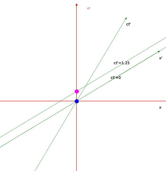

I hope so too, BUT there is still one thing that confuses me. In my other thread on another forum (topic is located here, but you don't need to look at it) user Alfred Centauri states that i should construct my image like shown below.
Question 1: Why is he using tilted lines (parallel to ##x'##) and not hyperbola in combination with horizontal lines (paralel to ##x##) like we did?
Question 2: Is he wrong?
Question 3: Are there maybe more ways to construct this diagram?
He's describing a passive transformation, where instead of actually boosting the pink dot along a hyperbola, you simply draw new axes and evaluate the coordinates with respect to the new axes. These are equivalent (though obviously not exactly the same). Let me explain. You can do one of two things:
1) You could boost the pink dot along a hyperbola and evaluate its coordinates with respect to the original ##x,ct## axes. This is what you attempted to do.
OR
2) You can draw new ##x', ct'## axes and evaluate the coordinates of the pink dot with respect to these new axes, the ##S'## frame. This is what Alfred Centauri did.
(1) is called an active transformation. (2) is called a passive transformation. They are closely related. I even suggested using a passive transformation earlier because I felt it would be clearer.

If i add passive transformation along the active one i get the distance which i wrote as ##\Delta t''##. What is this? It is not the same value as my ##\Delta t'## which i got using the active transformation.
Here is the picture. I only added a line parallel to ##x'## axis and marked a distance ##\Delta t''##.
http://shrani.si/f/N/h8/1dEH9KWY/lol.png
It may not look that way, but I assure you the numerical value of ##\Delta t''## is indeed ##1.15##. I think the drawing looks a little worse than it should (is that hyperbola really correct?), but otherwise, the gist of it gets everything across that it should.
It is not a real hyperbola, so maybe this is the case. Could anyone provide a picture which proves this?

71GA said:
"Numerical value of ##\Delta t''##" as measured in frame ##x'ct'## or as measured in ##x,ct##?
##\Delta t''## is the time coordinate of the point ##1## with respect to the ##S'## frame.
I personally cannot, and while the diagrams are handy for seeing things, at some point I think one must rely on the equations to get something precise. This is why I'm not really a fan of all the delta's you've been using. It's easier to use coordinates because then you can put those coordinates into equations.
Let point 1 lie at ##(c t_{(1)}, x_{(1)})##. This is in the ##S## frame. Equivalently, it also sits at ##(ct_{(1)}', x_{(1)}')## in the ##S'## frame.
Your ##\Delta t = t_{(1)}##.
Your ##\Delta t' = t_{(1')}##, the time coordinate of ##1'## in the ##S## frame.
Your ##\Delta t'' = t_{(1)}'##, the time coordinate of point ##1## in the ##S'## frame.

Are those lines really needed? If not i would prefer not to include them as they make my picture unreadable. If i want to explain it to someone i have to use multiple pictures and not only one. Otherwise it gets messy.
pervect said:
One important pre-requisite, which I'll call PRE. Make sure that the Lorentz interval, also called the proper time, between the origin and point 1 is the same as the Lorentz interval between the origin and point 1'. I think you addressed this by saying that points 1 and 1' should both be on the same hyperbola of (ct)^2 - x^2 = constant.
How do you mean the same? Explain please.
pervect said:
In the (t,x) frame, line 1 represents the set of points simultaneous with the event you labelled as "1". Find point 2, where this line intersects Ranja's worldline.
I think that my "point 2" is in the origin of frames.
pervect said:
Time dilation says that point if point 1' occurs after point 2, because using the simultaneity conventions of the (t,x) frame, the clock in the (t', x') frame is ticking slowly. (Be sure that the precondition PRE is met!)
"Point 2" is the origin and it is an event which happens before event labeled ##1'## does.
pervect said:
In the (t', x') frame, line 3 represents the set of points simultaneous with the event you labelled as 1'. Find point 3, where this line intersects Ziga's worldline. Time dilation says that point 1 comes after point 3. Again, be sure the precondition PRE is met.
Why are these lines and points so important for me to include in the picture?
Prevect is saying that you should ensure the spacetime interval between point 1 and the origin has the same numerical value as the spacetime interval between point 1' and the origin. Saying that they both lie on the same hyperbola (which is a curve of constant spacetime interval) is enough to accomplish this, and I believe that's what you did.
A hyperbola is a curve of constant spacetime interval just as a circle is a curve of constant Euclidean interval (distance).
I thought so.
I could use this to prove that for observer in primed frame thinks time interval of an observer in unprimed frame is longer. I think.
