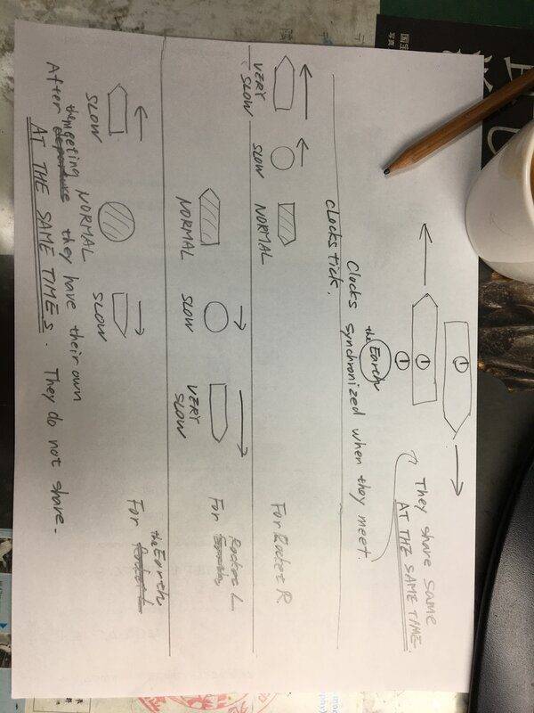

In the special theory of relativity synchronicity of different places is not absolute one as it is in our daily lives e.g. London and New York shares the same moment and same TV news. When they are away and in relative motion, his AT THE SAME TIME and her AT THE SAME TIME are different. One can interpret other's AT THE SAME TIME is not his/her own so no confusion take place.
Please find attached my hand drawing. There two rockets pass by the Earth. The three do not share AT THE SAME TIME any more when they are apart. The clocks tick NORMAL, SLOW or VERY SLOW by relative speed.
Please find attached my hand drawing. There two rockets pass by the Earth and the three do not share AT THE SAME TIME any more when they are apart.
In your sketch, I think you had it the other way: the Earth is moving very slowly, and the rocket is moving slowly. That's because the velocity as seen by the "moving rocket" in its own frame is ##(v_e+v_r)/(1+v_ev_r/c^2)## where ##v_e## is Earth's velocity and ##v_r## is the other rock's velocity, both measured by the rocket at "rest". And these two velocitites got the same sign. So the Earth is moving slower than the other rocket.
For reference, http://hyperphysics.phy-astr.gsu.edu/hbase/Relativ/einvel.html
I think that you have misunderstood what @anuttarasammyak was attempting to depict. The drawing was not trying to depict relative rates of motion but rather relative rates of time passage -- time dilation.
The scenario had a rightward moving rocket, a leftward moving rocket and the earth.
From the rest frame of the leftward moving rocket, the Earth is moving rapidly rightward and the other rocket is moving even more rapidly rightward. Accordingly, from this frame, time is passing slowly on the Earth and even more slowly on the other rocket.
From the rest frame of the Earth, one rocket is moving rapidly rightward and the other rapidly leftward. Accordingly, from this frame, time is passing slowly for both.
From the rest frame of the rightward moving rocket, the Earth is moving rapidly leftward and the other rocket is moving even more rapidly leftward. Accordingly, from this frame, time is passing slowly on the Earth and even more slowly on the other rocket.
The key take-away is that everyone calculates everyone else's clocks to be running slowly. Time dilation is symmetric.
That is all that the drawing depicts. It is purely qualitative. There was no attempt to be quantitative and invoke the relativistic velocity addition formula. There was no attempt to include the relativity of simultaneity -- the "leading clocks lag" rule. There was no attempt to account for gravitational time dilation. Nor was there any attempt to adopt "the" non-inertial frame of an clock being accelerated in a circular orbit [or of an inertial clock in a ballistic orbit in curved space-time].
