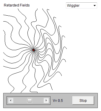

I need to know where to look to find the proof (mathematical derivation) that any arbitrary sphere (at rest with the observer) surrounding the charge like that in the above picture (also in the attachment below) would have a constant integral of the E-field (value of electric flux) on its surface (based on the proper time in the frame shared by the observer and the sphere upon which the surface integral is computed) under these particular circumstances.
Certainly what you are looking for can be found, but doing it that way completely loses the point of the power of something like Gauss's law. The major power of Gauss's law is that we DON'T HAVE TO carry out that ridiculous integral, we already know the answer. If we had to carry out that ridiculous integral (where no symmetries are present), then we've completely missed the point and power of Gauss's law.
Think of it in terms of electric field lines in the same line of thought as Faraday's. No matter how that electron moves around, the number of field lines crossing a closed surface must remain constant as long as the charge itself does not move outside that surface. This is because although the field lines can get wavy or distorted, they cannot ever cross each other, they will not "multiply" (in the sense of the creation of more field lines), and they must start on the charge and end at infinity (since you have only 1 charge around). The number of field lines crossing the surface is exactly the electric flux.
A lot of people get bogged down by the specifics of what the field looks like "on the surface".
An alternative way to see this, if you are not satisfied with Faraday's picture of field lines, is to see simply that Maxwell's equations in differential form is completely in accord with special relativity, and the integral forms of Maxwell's equations can be obtained from the differential form by the generalized Stoke's theorem (which is also completely general).
One last point is that the Wigner Eckhart potentials, which are THE solution to E&M (in the sense that you can get the E&M fields from them for an arbitrary distribution of arbitrarily moving charges), are explicitly derived from Maxwell's equations. So, even if you get "time retarded potentials" that you are looking for, etc., they come from he Wigner-Eckhart potentials which come from Maxwell's equations!

If I move charge quickly from rest the center of the sphere to the right side of a sphere (with respect to the viewer) at 0.999c, I would expect that the flux integral on the right side to be higher than that on the left side. Furthermore, while the charge being on the right side of sphere is closer to the right inner wall than the left inner wall at all times after t=0, where acceleration begins at t=0.
Just consider the following:
If the charge is at the center, the electric field intensity should be constant at all parts of the sphere. So 50% of the total integrated value is on the left hemisphere, and the other 50% of the total integrate value is on the right hemisphere.
If the charge is at very close to the azimuth of the right hemisphere, the electric field intensity should vary at all parts of the sphere. For example, if 10% of the total integrated value is on the left hemisphere, and the other 90% of the total integrate value is on the right hemisphere.
The problem is:
* Most of the left hemisphere will receive the field intensity from that charge when it was closer to the center than the azimuth of the right hemisphere.
* Most of the right hemisphere will receive the field intensity from that charge when it was closer to the the azimuth of the right hemisphere.
Yes, but the point is that the surface is closed...and so the inhomogeneities cancel.
The TOTAL flux out of a closed surface is equal to the charge.

The intensities may go up on that side, but the vector directions will tend to change. Remember that a moving charge's electric field tends to get stronger in the perpendicular directions and weaker in the parallel direction. In this case, the vectors, even though they are longer, rotate away from the normal of the sphere so the flux is conserved.
Just take a look at the picture you posted. No matter what circle I draw on that picture, even if I deform that circle, the same number of lines will pierce my circle.
Gauss's law is really only a statement that electric field lines must start and end on charges. This is one of the great utilities of Faraday's "electric field lines" picture. His picture makes this argument very transparent, whereas vector fields make this argument very complicated. That integral that you want to do is ridiculous, but we already know the answer!
Remember that Gauss's law holds not only for a surface of a sphere centered at my charge, it holds for ANY surface with my charge enclosed. I can draw any deformed, amorphous blob shape I wanted. The integral would be ridiculous, but the answer is the same! Why do you not question this aspect of Gauss's law? It is, as far as I'm concerned, completely analogous.
I think I outlined this in my last post already.

Don't confuse electric field LINES and electric field VECTORS. These are two compatible, but distinct, models for electromagnetism. The flux out of that sphere is EITHER the integral of the VECTORS (which depends on angle, and intensity and whatnot, and is, in general, very hard to calculate directly), or simply the number of field lines that pierce the sphere (which is very easy to see).
I did address your previous post directly. I told you that the angles for the VECTORS rotated away from the normal(s) to the sphere, and thereby compensate for their increased intensities. Your numbers 10%, 90%, and 50% are just example numbers, I don't get why you want me to address these 3 numbers directly?
You don't have 90% of the flux going in one sphere and 10% going the other. You may have something like 60% in one and 40% in the other (which, by the way, still adds up to 100%, so you haven't increased net flux at all) because the vectors turning has compensated for this effect. The lagged behind vectors don't rotate as much, but they don't grow, while the vectors in front of the electron grow but rotate away from the normal.

1) Electric field lines and electric field vectors are 2 fundamentally different (although compatible) models for the electric field.
Electric field vectors are always tangent to field lines, but the method by which they represent the STRENGTH of the electric field differ.
The field vectors represent STRENGTH by the vector's MAGNITUDE (longer=stronger), whereas the electric field lines represent STRENGTH by the DENSITY of lines (denser=stronger).
2) 60% and 40% are merely example numbers just like your 10% and 90%. All I was trying to get at is that the vectors where the electric field is stronger will tend to be rotated away from the normal of the surface.
3) Thinking about this problem using Faraday's idea of electric field lines is the simplest way to think about it.

phi-0, the angle, h, between the outward-facing normal at latitude phi and the z component of the electric field
Due to the angle between phi and nu, only some fraction of the electric field, |cos(f)|*100% of it, will contribute to the field normal to the surface at latitude phi.
Of the r component of the electric field, which is sin(nu)*100% of the total non-relativistic electric field, |cos(g)|*100% of it will contribute to the field normal to the surface at latitude phi.
Of the z component of the electric field, which is |cos(nu)|*100% of the total non-relativistic electric field, |cos(h)|*100% of it will contribute to the field normal to the surface at latitude phi.
In the non-relativistic case, the electric field is inverse with the square of distance.
In the non-relativistic case, the electric field is proportional to 1/(sin(phi)^2+(cos(phi)-t)^2).
In the relativistic case, there is an increase of the lateral electric field by the factor gamma.
gamma=1/sqrt(1-vv/cc)
Given that c=1, this reduces to:
gamma=1/sqrt(1-vv)
In the relativistic case, the r component of the electric field normal to the surface at latitude phi=
|cos(g)|*(1/sqrt(1-vv))*(1/(sin(phi)^2+(cos(phi)-t)^2))*100% of the total non-relativistic electric field.
The increase does not apply to the z component of the electric field, which has strength of=
|cos(h)|*(1/(sin(phi)^2+(cos(phi)-t)^2))*100% of the total non-relativistic electric field.
The sum of these two gives the total relativistic electric field normal to the surface at latitude phi, with a strength of=
(|cos(g)|*(1/sqrt(1-vv))+|cos(h)|)*(1/(sin(phi)^2+(cos(phi)-t)^2))*100% of the total non-relativistic electric field=
(|cos(phi-pi/2)|*(1/sqrt(1-vv))+|cos(phi)-0|)*(1/(sin(phi)^2+(cos(phi)-t)^2))*100% of the total non-relativistic electric field=
(|cos(phi-pi/2)|*(1/sqrt(1-vv))+|cos(phi)-0|)*(1/(sin(phi)^2+(cos(phi)-(( sqrt((1-cos(phi)*vv)^2-(vv-1)^2) - (1-cos(phi)*vv) ) / (vv-1)))^2))*100% of the total non-relativistic electric field
This will allow us to determine the relativistic electric field strength that is normal to the surface at phi recorded at synchronized time t=1. Then it is simply a matter of integrating the electric field over the surface to get the electric flux detected at the sphere.
I will spare that integration for another day. Instead, I will display the following results that I got for the formula I used to solve for t as a function of phi (in degrees from the +z direction).
