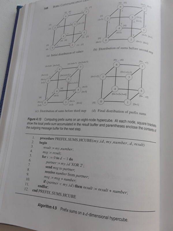

##T = (t_s + t_w*m) * log_2 p## p=167 (see attached image p167... i.e equation (4.5)), equation to analyze(answer)
Is the time required equal to :
##T = (t_s + t_w*m) * log_2 p + p * t_{add}##
Note : image p168... contains description of algorithm (i.e Algorithm 4.9)
Some body please guide me is my equation (answer) correct or not?
Zulfi.
