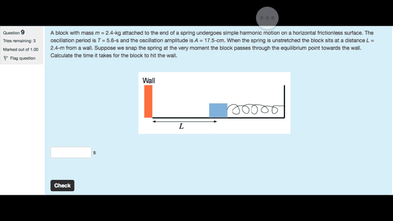

Time taken for a mass on the end of a spring to hit a wall
The discussion revolves around a problem involving the dynamics of a mass attached to a spring and its interaction with a wall. Participants are exploring the time it takes for the mass to hit the wall, which involves concepts from mechanics and oscillatory motion.
