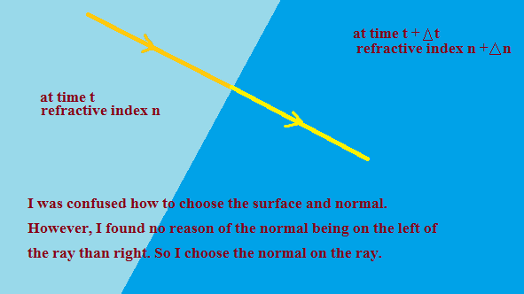

Suppose, light is passing through a liquid whose refractive index is time-varying. What will be the path of light ray ? Will it be a straaight line or curve ?
I think, it will be a straight line.
arpon said:
time-varying
Are you certain the problem statement specified "time varying" and not a spatial variation such as refractive index of atmosphere with altitude?
No spatial variation.
I agree with your reasoning. By symmetry, there is no reason it should start curving one way rather than the other.
