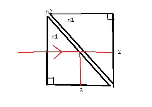

Two Prisms connected by a material of refractive index n

The prisms have a refractive index ##n_1=1.3## at wavelength ##\lambda=300nm## and are connected by a material with refractive index ##n_2##. What is the refractive index ##n_2## so that light of wavelength ##>\lambda## follow path 2, and light at ##<\lambda## follow path 3?
##\sin\theta_c=\frac{n_2}{n_1}##
##n=\frac{c}{v}=\frac{c}{f\lambda}##
I am very confused as to how the wavelength of light effects total internal reflection. I can solve for the frequency of the light by using ##n=\frac{c}{f\lambda}\Rightarrow f=\frac{c}{n\lambda}## but I'm not entirely sure this is useful. I also have that ##\sin\theta_c=\frac{n_2}{n_1}## which can be rewritten as ##\sin\theta_c=\frac{\lambda_1}{\lambda_2}## The critical angle is a constant in this case I think? it's 45 degrees since the light is always coming in parallel to the bottom of the prisms but I don't understand how varying ##\lambda## is going to change whether or not it exits the prisms.
The question only says that n1 is 1.3 at a particular wavelength: 300nm. Do you suppose it could be different at other wavelengths? How would it vary?

The refractive index depends on the wavelength, so the critical angle depends on it as well. Here, the transition between total reflection and transmission is supposed to be at a wavelength of 300 nm, so you can calculate the necessary refractive index at 300 nm to be directly at the transition.

So the correct refractive index then is ##n_1=\frac{n_2}{\sin\theta_1}##, edit: I mean ##n_2=n_1\sin\theta_1## sorry for all the mistakes I'm on my phone
