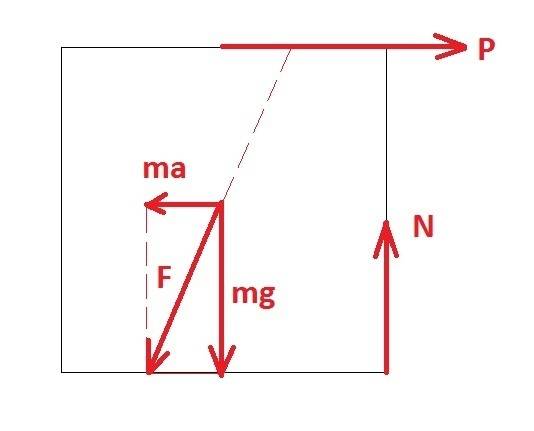

I'm sorry, wrong statement :rolleyes: It should be: If mu = 0, a cannot be g/2.
Consider your answer + your analysis when N (the normal force) is taken into account (see picture). In the reference frame of the center of mass, the cube stays at rest, so all the conditions about forces and torques in equilibrium can be applied (notice: in the reference frame of the ground, the cube is moving with acceleration, and that makes things tricky in this reference frame!).
We have 3 forces: P, F (which is mg + the fictitious force ma) and N. As you computed, a=g/2, so the forces should look like in the picture. The important point is, they do not converge into 1 point (the three forces P, F and N), which violates the equilibrium condition.

In your diagram appear the force "ma", which I think is not there in the moment the cube is about to topple.
In my diagram there were of course only P and mg, and of course the toppling condition was g/2.
The force "ma" I think should not be there.

The ma force is the fictitious force, arising from the choice of reference frame (see my previous post, if you didn't read carefully). If your diagram contains only P and mg (and N presumably), then you probably chose the reference frame of the ground. In that reference frame, the cube is moving with acceleration, and this makes things more complicated. The simple formula torque = moment of inertia x angular acceleration doesn't always work. There are many subtleties behind it.
My answer is a = g(1-2mu).
P.S.:
To further elaborate on my points of the subtleties: The reason we can deduce the formula Torque = Moment of Inertia x Angular Acceleration is that we assume that the pivoting point is fixed and the body is a rigid body (so that the whole body rotates around the pivoting point with uniform angular acceleration). From this formula, we deduce the second equilibrium condition: Torque = 0 as Angular Acceleration must be 0 under equilibrium (the same for F = ma; as a must be 0 under equilibrium, F has to be 0).
However, in this problem, in the reference frame of the ground, the pivoting point (right lower edge of the cube) is moving and the cube doesn't simply rotate around any point. That is, the cube is not even in equilibrium. Incautiously applying the equilibrium condition here certainly messes things up. On the other hand, if we choose the reference frame of the center of mass, the cube would be under equilibrium, and things are way easier.
P.S.:
