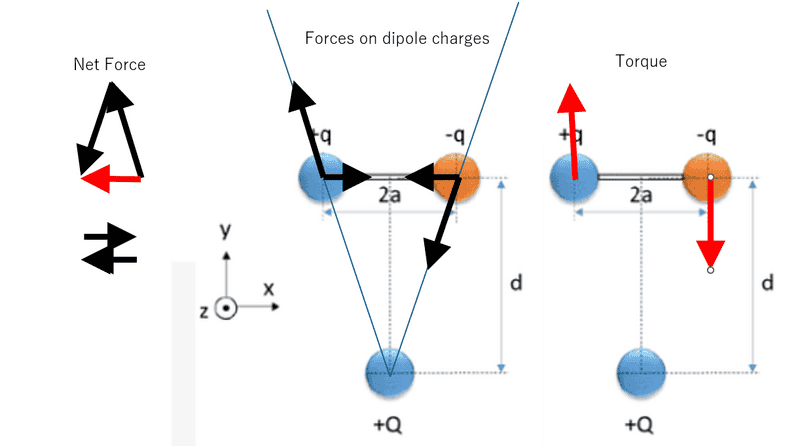

Please see below
##\vec \tau=\vec p \times \vec E##
##\vec E=\frac{kQ}{r^3} \vec r##
Electric field acting on the dipole due to ##+Q## is the sum of ##E## on ##+q## and ##-q##
$$\vec E=\frac{kQ}{(a^2+d^2)^{\frac{3}{2}}} (-a\hat x+d \hat y)+\frac{kQ}{(a^2+d^2)^{\frac{3}{2}}} (a\hat x+d \hat y)$$
$$=\frac{2kQd}{(a^2+d^2)^{\frac{3}{2}}} \hat y$$
So,
$$\vec \tau=\vec p \times \vec E$$
$$=-P\hat x \times \frac{2kQd}{(a^2+d^2)^{\frac{3}{2}}} \hat y$$
$$=-\frac{2kQdP}{(a^2+d^2)^{\frac{3}{2}}} \hat z$$
But the answer key has no 2 in the numerator. What is my mistake?
Thanks

I think you have a different problem. Check the signs in the right half.

Which way should the net force be, looking at the diagram?
And in your final answer, should the torque increase as d increases and should it decrease as a increases?
The problem is counting the electric field twice …

anuttarasammyak said:
How about dealing forces on +q and -q individually to calculate torque by them ?
By using this method, I got the vertical force on ##+q## to be ##F=\frac{kQqd}{(a^2+d^2)^{\frac{3}{2}}} \hat y## and the torque to be:
$$\vec \tau=2 (-a \hat x) \times \frac{kQqd}{(a^2+d^2)^{\frac{3}{2}}} \hat y$$
$$=-\frac{2akQqd}{(a^2+d^2)^{\frac{3}{2}}} \hat z$$
$$=-\frac{kQdP}{(a^2+d^2)^{\frac{3}{2}}}\hat z$$
The answer is correct but I still don't understand why my method in #1 is wrong
Isn't the electric field used in ##\vec \tau=\vec p \times \vec E## is the sum of electric field on ##+q## and ##-q##?

As @Orodruin posted, you are double-counting the field. There is no principle that says you can take the field at one place and the field at another and add them. You can add two independent fields acting at the same point, but the two fields you added are the same field.

Absolutely not! It is the electric field at the dipole. The approximation mafe is that it is a point dipole.

No, it isn’t. The field ##\vec E## in ##\vec\tau = \vec p \times \vec E## is the field at the idealized dipole and absolutely nothing else.

No, they did not. They added the fields at q and at -q.
It works because field by -q on q does not contribute to torque and translational motion of the dipole by cancelling pair.
No, it doesn’t work. You cannot add fields at different points.

@songoku, it’s probably worth noting that ##\vec \tau=\vec p \times \vec E## applies when the field is uniform over the dipole (so the field has the same magnitude and direction at each end of the dipole).
This does not apply in the present problem, though it would be a sensible approximation if ##d \gg a##; in this case you would use the field’s value at the centre of the dipole.
I would phrase this differently: It applies to an ideal dipole, ie, in the situation when ##a\to 0## with constant dipole moment.
Calling the charge configuration shown a dipole is also somewhat misleading. Yes, the leading contribution to the far field is the dipole moment, but it is not a pure dipole - it also has higher moments, just no monopole moment.
The statement of the problem can be criticized on the basis that it does not specify the point about which the torque is to be calculated. The reference point is irrelevant if the expression ##\vec \tau = \vec p \times \vec E## is used. However, this expression, as has already been pointed out, is valid for a "point" dipole, i.e. with the understanding that the electric field is uniform over the "length" of the dipole. This is not the case here because ##d\approx 2\times(2a).##
The forces acting on the system are $$\mathbf F_1=\frac{kQq(-a\mathbf {\hat x}+d \mathbf {\hat y})}{(d^2+a^2)^{3/2}}~;~~\mathbf F_2=-\frac{kQq(a\mathbf {\hat x}+d \mathbf {\hat y})}{(d^2+a^2)^{3/2}}\implies \mathbf F_{\text{net}}= -\frac{2kQq a}{(d^2+a^2)^{3/2}}\mathbf {\hat x}.$$This net force produces a torque that changes the "orbital" angular momentum about any point that does not lie on the line joining ##+q## and ##-q##. Judging from the known answer, this torque is not what the problem is asking us to find.
The problem is asking about the torque that changes the "spin" angular momentum about the midpoint between the charges. Then $$\mathbf N_{\text{spin}}=(-a\mathbf {\hat x})\times\mathbf F_1+(a\mathbf {\hat x})\times\mathbf F_2=-\frac{2kQq ad}{(d^2+a^2)^{3/2}}\mathbf {\hat z}.$$ As always, one should not mention "torque" or "angular momentum" without specifying the origin with respect to which these position-dependent vectors are defined.

Ummm, you did not evaluate ##\vec{E}## at the position of the dipole. Instead, you evaluated [the relevant component of] ##\vec{E}## at the ends of the dipole.
This is obviously the right thing to do. But it is not the same as computing ##\vec p \times \vec E##.

Consider this general derivation of the torque on the dipole about the mid-point between the charges.
Let ##2d## be the separation between the charges.
Let charge ##(-q)## be at location ##\mathbf a## where the electric field is ##\mathbf E##
Let charge ##(+q)## be at location ##-\mathbf a## where the electric field is ##\mathbf E +
\delta \mathbf E ~,~(\delta \mathbf E \neq 0).##
The dipole moment is ##\mathbf p=-2q\mathbf a.##
The net torque about the midpoint is
$$\begin{align} & \mathbf N_{\text{net}}=(-\mathbf a)\times(+q)(\mathbf E +\delta \mathbf E)+\mathbf a\times(-q)\mathbf E =-2q\mathbf a\times \mathbf E-q\mathbf a\times \delta \mathbf E \nonumber \\
& \mathbf N_{\text{net}}=\mathbf p\times\mathbf E+\frac{1}{2}\mathbf p\times \delta \mathbf E. \nonumber
\end{align}$$Here, ##\delta \mathbf E## is in the negative x-direction which makes it parallel to the dipole moment. Therefore, the second term in the above expression vanishes and you are left with ##\mathbf p\times\mathbf E.##
