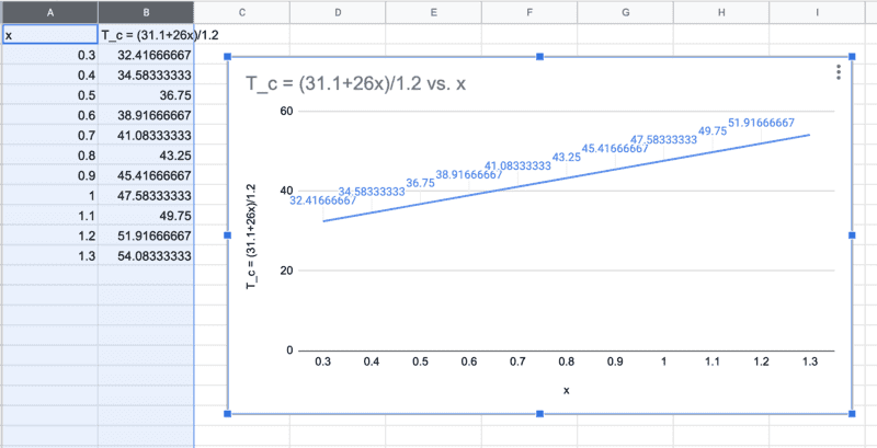

C) if the sign is moved farther away from the wall, does the magnitude of the force on the hinge H increase, decrease, or stay the same? Justify your answer.
D) sketch a graph of the magnitude of the tension in cable C as the sign is moved further away from the wall. The scale of the y axis is not important, and does not need to be fill in. Only the shape and the location of the intercepts will be considered. The closest the left chain can get to the hinge is 0.30m away, and the maximum distance is 1.3m.

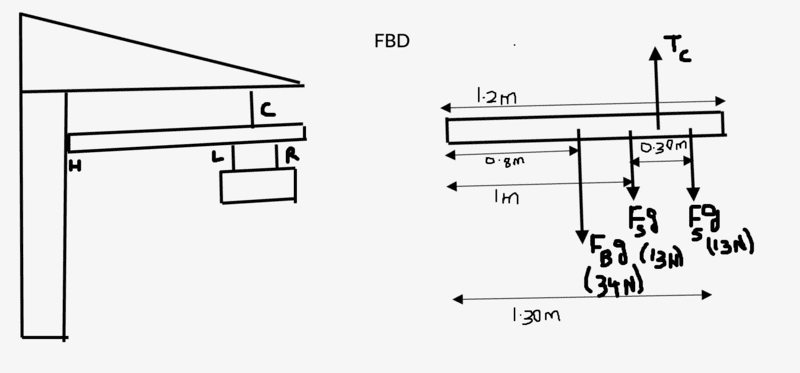

Torque = F x d
Part -B
$$\sum \tau_{cw} = \sum\tau_{ccw}$$
$$\tau_B=\ torque\ of\ the\ beam $$
$$\tau_S =\ torque\ of\ the\ sign\ board$$
$$\tau_C = \ torque\ of\ the \ cable$$
$$\tau_B+\tau_S = \tau_C$$
$$F_B\cdot d_1 + F_S\cdot d_2 = F_C \cdot d_3$$
Since the tension in the left and right chains are evenly distributed I took ##F_S## as 13N, 13N and their corresponding distances.
$$ 34\cdot 0.8+13+13\cdot 1.3 = T_C\cdot 1.2$$
$$ T_C = 47.58 ~\rm{N}$$

Part -C
As the sign is moved farther away from the wall, the magnitude of the force on the hinge will increase because torque produced depends on the magnitude of the force and the perpendicular distance between the point about which torque is calculated and the point of application of force. And so as the distance increases magnitude of the force on the hinge will increase. So, mathematically torque is represented as:
$$ \tau = Fr\sin\theta$$

I don’t know whether I’ve done them all right or I need to do any corrections.
If you wish us to check your answers, I can only speak for myself that I would prefer not to do that. That's because I would have to solve the problem from the start and put in numbers to compare with your numbers. It would be easier to check your work if you provided your answers in symbolic form and the given numerical constants, e.g. ##d_1##, ##d_2## etc. Also, that would be the way to answer parts (c) and especially (d). Once you have the symbolic expressions, you can put in the numbers. I will be happy to compare my symbolic expressions with yours.

paulimerci said:
Part -C
I would reconsider that statement.
Consider the point of connection of the cable to the bar as a pivot and do a balance of moments about that point.
You can then find the direction and magnitude of the reaction on pivot H for each of both conditions.
Also, in your diagram, it seems that you incorrectly label F times g as a force.

Solution for Part -B,
A hinged bar of mass ##M## 3.4kg attached to a wall and is supported by a cable C. A sign is suspended from two chains and is attached to a bar. The mass of the sign ##m## is 2.6kg.
The bar is assumed to be uniform. Therefore, its weight force is applied at the half way point (0.8m). By taking the left-hand side of the rod (H) as our axis of rotation, the torque from force R is zero, leaving us with the following equilibrium statement for torques.
##d_B = 0.8m## is the moment arm distance from the hinge to the COM of the bar, ##d_S=1.15m## is the moment arm distance from the hinge to the COM of the sign board, and ##d_C = 1.2m## is the moment arm distance from the hinge to the cable. The sum of all torques through contact point H must be zero, both weights produce clockwise torques! solving for ##T_C## in the below equation, we get
$$\sum\tau = Mg\cdot d_B + mg\cdot d_S - T_C\cdot d_C$$
$$ = 34\cdot 0.8 +26\cdot 1.15 - T_C\cdot 1.2$$
$$ T_C = 47.58~\rm{N}$$
I did only for part - B for now, just want to check whether I did it right at-least for this one.

Good so far.

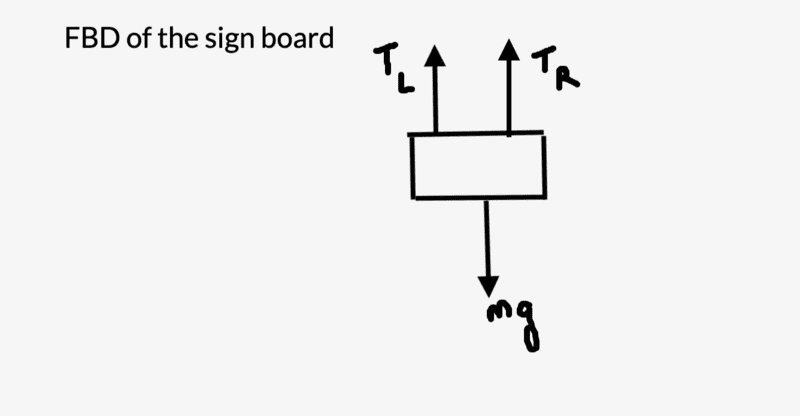

paulimerci said:
Any hints on how to solve for Part A?
Draw a free body diagram (FBD) of the sign.
The sign is in a state of equilibrium and thus all the forces acting upon it must be balanced. The leftward pull of cable L must balance the rightward pull of cable R and the sum of the upward pull of cable L and cable R must balance the weight of sign.
Where the upward pull of left cable is taken as ##T_L## and rightward pull of cable is taken as ##T_R##.
Therefore,
$$ T_L + T_R = mg $$
Since leftward pull must balance the rightward pull, we can write ## T_L = T_R = T##. Therefore, substituting ##T_L ##and ##T_R## as ##T## in the above equation we get,
$$ T + T = mg$$
$$ 2T = 2.6 \cdot 10$$
$$ T = 13~\rm{N}$$
Therefore,
$$ T + T = mg$$
$$ T = 13~\rm{N}$$
We can conclude each cable pulls upwards with a force of ##13~\rm{N}##. I.e., ##T_L= 13~\rm{N}## & ## T_R = 13~\rm{N}##.
That is correct. You have solved part (a). Proceed to part (b) with a FBD of the bar. Please use symbols TL and TR for the tensions even though you now have numbers for them.

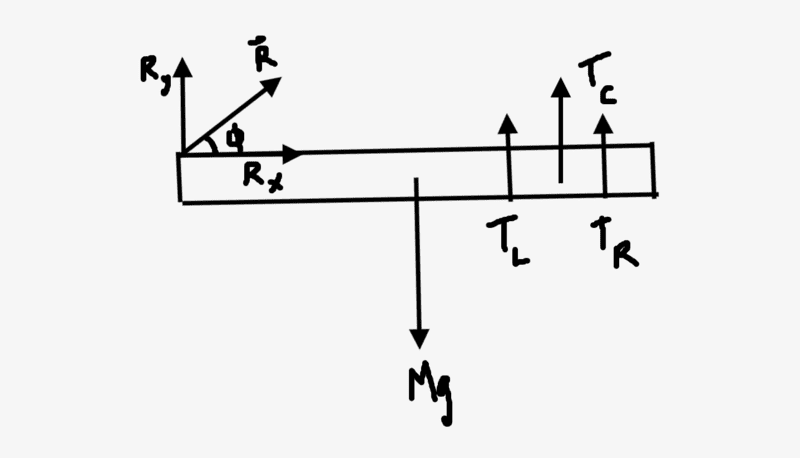

The system is in static equilibrium and so the net forces are equal to zero. The reaction force ##R## is the response of the wall to the bar and acts at an angle ##\phi##. Thus, we state that
$$\sum F_x = R_x =0$$
$$\sum F_y = R_y + T_c +T_L+T_R - Mg$$
$$R_y = Mg -T_c-T_L-T_R$$
I'm getting reaction force along the vertical component as negative.
If a chain exerts a force on the sign directed up, what is the direction of the force that the chain exerts on the bar?
Oh yes, I never thought that. The direction of the force that the chain exerts on the bar is down.
$$\sum F_y = R_y + T_c- Mg - T_L -T_R$$
$$ R_y = Mg + T_L + T_R-T_c$$
$$ R_y = 36 + 13 +13 -47.58$$
$$R_y = 14.42~\rm{N}$$
And so the ##R## force from the wall is entirely vertical.

The sign is 0.4 m wide and has weight 26 N. The left chain is 0.1 m from the left edge and the right chain is right on the edge at 0.4 m from the left chain. Are the tensions ##T_L## and ##T_R## equal? Why? If they are not equal, find the teo tensions.
Related to all this is the equation you posted in #7 $$\begin{align}\sum\tau & = Mg\cdot d_B + mg\cdot d_S - T_C\cdot d_C \nonumber \\ & = 34\cdot 0.8 +26\cdot 1.15 - T_C\cdot 1.2 \nonumber \\T_C & = 47.58~\rm{N} \nonumber \end{align}$$I can see that in the second line 26 is the weight of the sign, but where did the ##1.15## come from? One chain is at 1.00 m and the other at 1.30 m from the hinge.

That's right but for the ##d_s## I took ##1.15m## which is the moment arm distance from the hinge to the COM of the sign and not separating the chains.
I don’t understand how to find for ##R_y## in terms of x. Can you give some hints?
