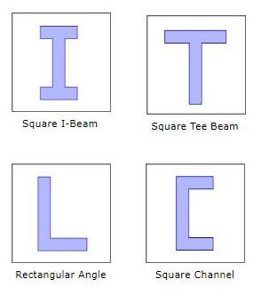

How to calculate maximum shear stress and twist angle of a thick-walled arbitrary open cross-section (e.g. I, T, L, C) bar subjected to torsion ?
Hi,
I analyzed various open cross-section (I, T, L, C) bars using FEA to find maximum shear stress and twist angle. Now I would like to compare these results with approximate hand calculations. Just out of curiosity. However it's not easy to do it analytically. I know about a method of dividing open section into several rectangles and calculating and then summing their torsion constants. Unfortunately the books say that this method applies to thin-walled sections and I would like to solve some thick-walled bars. So is there any other approximate method I could use or maybe the one mentioned above can be used even for thick-walled bars ? Of course I realize that results won't be exact. If there's no approximate method then do you know about any examples for these sections with the use of differential equations ?
Thanks in advance for your help
Can you please give an example of the kind of shape you are analyzing?
Sure, here's a picture showing sections I would like to analyze:
They are all typical open profiles often used for bars. Thus I'm a bit surprised that it's so hard to find any examples of torsion calculations for these profiles.
Source of images: https://structx.com/geometric_properties.html
If you go to your above reference and click on each of the pictures, it will open a page with the applicable formulas you are seeking for that beam configuration.
Yes, among the properties listed on this website there are some related to torsion - polar moment of inertia and torsional constant. However I don't think that they can be used to calculate max shear stress and twist angle in this kind of section like it's done for circular section: ##\tau_{max}=\frac{Tr}{J_{z}}## and ##\theta=\frac{TL}{JG}## (##T## - torque, ##r## - distance from central axis, ##J_{z}## - polar moment of inertia, ##J## - torsional constant, ##G## - shear modulus). These formulas apply to circular sections only due to warping of non-circular shaft.

Thanks, I used the formulas designed for thin-walled bars to solve the examples that were previously analyzed with FEA and I've found out that there's a very good agreement. Apparently these methods are not limited to thin-walled bars only. Or maybe my examples were close enough to this approximation.
