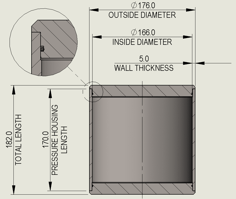

I’m designing a subsea sensor that will go to a max depth of 600 m (6 MPa/60 bar). In a simple model, it will be made of a pressure housing cylinder and two end caps, all grade 5 titanium. Some geometry is attached.
I’m looking for advice on how to calculate the thickness of the cylinder/pressure housing based on the pressure. I’ve done some research and found a few methods:
1. ASME Section VIII – Division 1 (UG-28)
2. EN 13445-3:2009 Part 3: Design (Section 8 Shells under external pressure)
3. ‘Designing Under Pressure’ in the Journal of Ocean Technology Vol. 3, No. 1, 2008 (Link here: https://www.thejot.net/article-preview/?show_artic...) with two theoretical results:
a. Von Mises (same as first part of EN 13445)
b. Windeburg and Trilling’s Buckling Pressure
Failure mode I can see is the combination of external pressure on the cylinder with the buckling load caused by the end caps pushing inwards.
Now I’ve run them through with the methods above and have varying outcomes for the pressure at yield:
1. 7.8 – 2.4 MPa for different grades of titanium (grade 5 not listed)
2. 11.5 – 10.5 MPa
3. a. 77.9 MPa, b. 46.5 MPa
As you can see it varies a lot and not all good with a 6 MPa limit – what methodology do I use? Are these even correct? The last method (Journal of Ocean Technology) is interesting in that it explores adding factors to account for manufacturing defects (circularity for example).
Thanks in advance and happy to provide more info.
I'm no expert in pressure vessel design, but is there a reason you chose to use a cylindrical shape and no internal bracing? It would seem to be an inherently weak design. Something more spherical with internal bracing would seem to be a better starting point, no?
There will be ports on the top and electrical connectors, therefore, not suitable for spherical design.
Bracing is a possibility, but internal space is very limited and I'm not sure how much I could add here (if any) as well as not knowing how I could calculate stresses involved.
As a side note, I have recently run FEA simulations with positive results - safety factor of ~7. But the aim here is to understand the hand calcs and then try to get something to match with the FEA.
It has been some time since I was involved in ASME Section VIII Div 1 calculations but to my memory the pressure limits were based upon stress allowables deemed safe for each listed ASME approved alloy rather than Sy and would therefore include an ASME approved safety factor.
Yes, I can see that since the process involves using their charts. Is my application definitely relevant for use with ASME Section VIII Div 1? I feel like it is, but it appears they've not written this spec for subsea applications specifically.
ASME Section VII Div 1 is focused on pressure vessels focused on plant and process services where there is a risk of injury or death of personnel and/or the potential release of toxic chemicals; and, as a result, it is extremely conservative; and, that probably accounts for its pressure limit being much lower than your two alternative calculation methods.
Section VIII is an excellent guide for the design of any pressure vessel service; but, unless the performance of your device is critical for safety, then its pressure limits may be lower than required for your equipment application.

...unless the performance of your device is critical for safety, then its pressure limits may be lower than required for your equipment application.
Ahh OK, makes more sense now. Still struggling with what the correct theoretical should be, though!
