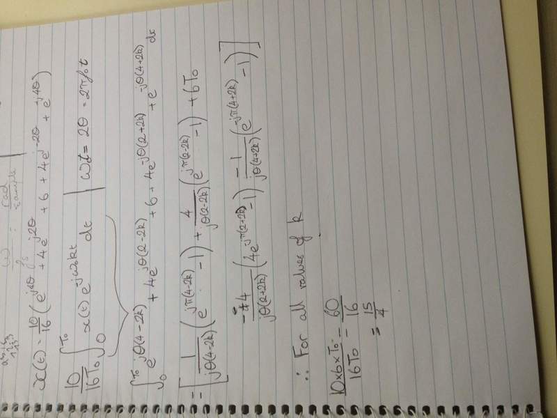

Compute the power contained in the periodic signal x(t) = 10.0[cos(160.7*pi*t)]^4
Hey guys,
I have just started Fourier Series and am struggling with this one. Without writing all my calculations, -I start with inverse Euler formula.
-Then integrate x(t)*e^(-j*ω*k*t) with respect to t. From 0 to (To)
-Then consider the value of the final exponentials when k is an odd and even number.
However i calculate that the answer for ak for any value of k to be 15/4?
Once again I have only started Fourier recently so any direction would be much appreciated.
Please show your work.
Another approach you might try is using trig identities to find the Fourier series.
Provided are my calculations in the attachment
-The function has already been converted using the inverse Euler formula
- σ is equal to 160.7*pi*t
- The fundamental frequency is 2*σ/(2*π)
-Anyway to calculate this equation is fine, inverse euler was just given as a suggestion to begin.
