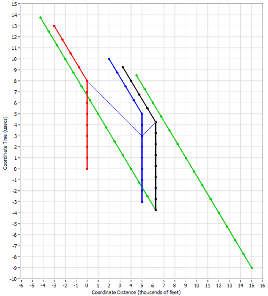

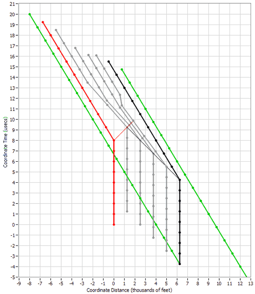

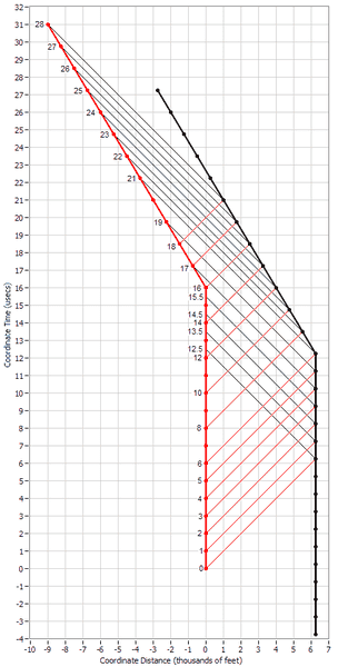

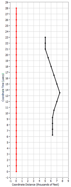

To make things clear, it helps to draw spacetime diagrams and use a specific scenario. Let's consider the train to be moving at 0.6c and to have a length in the platform IRF while it is moving of 5000 feet and we'll put the light source at 4000 feet from the rear of the train. In this spacetime diagram, I've shown the ends of the platform in green, the front of the train in black, the rear of the train in red, and the light source in blue:
As you can see, in the platform IRF, all parts of the train stop at the same time, at the Coordinate Time of 10 microseconds.
Now we can transform the above IRF to the train IRF by applying the Lorentz Transformation to all the Coordinates and we get this spacetime diagram:
Now you can see that the different parts of the train stop at different Coordinate Times ranging from 4.25 to 8 microseconds.
Does that clarify everything for you?

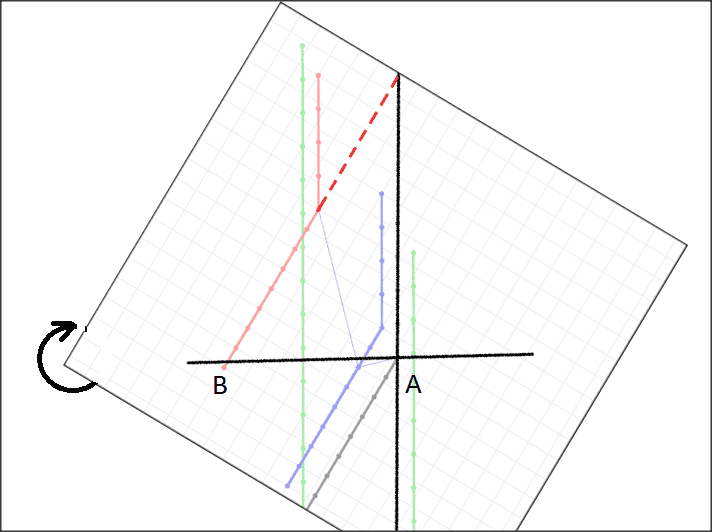

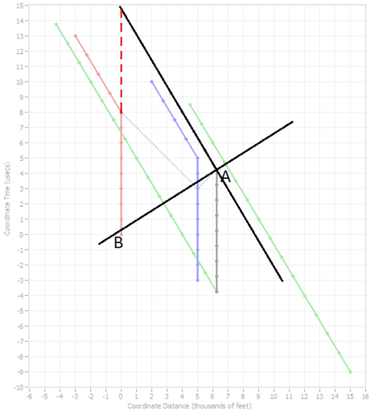

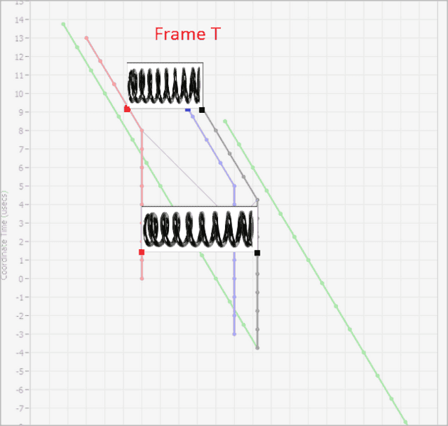

I drew a diagram quoted from yours. I fainted out the line colours but leaving the black and the red to represent A and B time-lines, respectively. The first one shows the time when A stops but B is still moving. The second one, I rotate the diagram clock-wise to bring the A at the origin with its time-line is vertical.

It is a mistake to think there is no extra tension from the point of view of the platform. In fact, due to Lorentz contraction the observer at the platform would expect the train to change length when it stops. That 's not happening which means the train must be under stress either before it stops or after it stops (or both).

This isn't a good way to say what is happening. In the IRF in which the train is originally at rest as depicted in my second drawing above, part B is still at rest while part A suddenly moves towards it. So the train is getting compressed, starting from the front and extending toward the rear. This is kind of like a train parked on the track experiencing a head on collision from another train coming toward it and then dragging it down the track.

In the platform frame, the train, because it originally is moving, is Length Contracted. It's Proper Length is longer and can be determined by a platform observer. When all parts of the train are brought to a stop simultaneously, the Proper Length instantly changes from its original longer length to a shorter length. This will create compression but Special Relativity can't say whether or not anything breaks. That has to be answered by a materials or structural analysis.
I have no idea what your drawings are trying to depict which means you probably have no idea what mine are trying to depict.

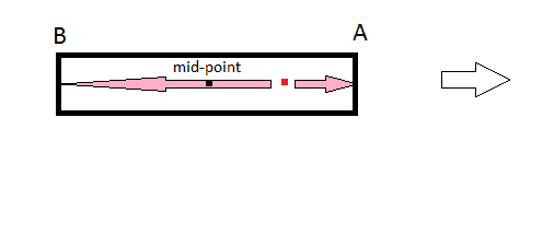

The length of the train, which is equal to the length of the coil, as seen by the external observer is shorter when the train is moving than when the train comes to a stop. So when the train stops, the length contraction effect disappears and the coil length increases suddenly as seen by the external observer. This should cause tension on the coil not compression.
What you are describing could happen when a train stops in an unrestrained way which would result in different parts of the train stopping at different times in the platform IRF but you said the different parts of the train stop simultaneously in the platform IRF. You can look at my first drawing to see that the length of the train under that specification does not change in the platform IRF.
In order for all parts of a train (or any object) to stop simultaneously according to a frame, there must be something like clamps set up all along the track which simultaneously stop the train (by preprogrammed timers) that bring all the parts to a halt (in that frame) and keep the different parts from expanding back to their natural length.
I can't help it if you specified an unrealistic scenario but that's what you did and Special Relativity doesn't address the realisticness of a scenario. That's why we can specify instantaneous accelerations (or decelerations) and see what happens in different IRF's even if they can't actually happen in reality.

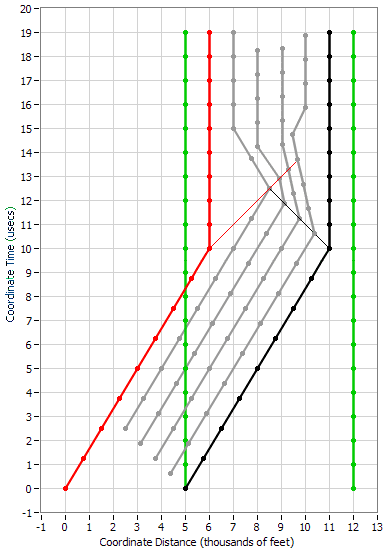

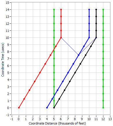

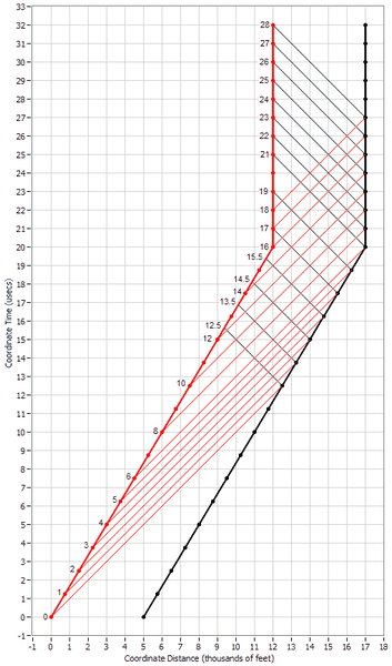

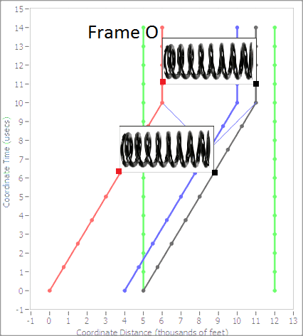

OK, then we'll go with my new scenario.
Here is a spacetime diagram showing a coil stretched between two locomotives. We assume that the coil can both get shorter (because it has been previously stretched) or get longer (because it can stretch even more) without breaking. And because we have an unrealistic scenario (instantaneous deceleration), we have to assume that the forces propagate at the speed of light (otherwise, the coil will break as soon as one part of it decelerates instantly). Some of the midparts of the coil are shown in grey. They start out separated by a thousand feet in the platform frame:
As you can see, all the midpoints continue to travel at 0.6c when the two endpoints suddenly stop. The coil is compressed starting from the front (black end on the right) until the forces, propagating at the speed of light as shown by the thin black line, cause the midpoints to respond. Special Relativity cannot provide an answer to how they respond. We have to make that up in our unrealistic scenario. To make things reasonably simple, I have assumed that the various midpoints respond by changing direction until the forces from the trailing end of the coil (red end on the left) have a chance to further constrain the coil.
In a realistic scenario, a coil (or any other structure that is not destroyed) will oscillate or vibrate until the motions all dampen out and they all come to rest with respect to one another as constrained by their two endpoints. This would take a very long time, not just a few microseconds. But I just want to give you the flavor of what happens. Although I show a large tension or stretching on the left side, in a realistic scenario, this tension would be intertwined with compression resulting in the oscillations or vibrations.
But the final result will be a more or less equal compression (actually, less stretching) of all parts of the coil from one end to the other. It will not end up all in tension. Again, these are issues that Special Relativity cannot address, they have to be determined by materials analysis. But once we decide how the midpoints oscillate during the dampening process, we can transform to any other frame, including the frame in which the train was at rest in the beginning of the scenario:

Not according to the way you specified the problem. The way you specified the problem, both ends of the train stop at the same time in the frame in which the train is originally moving (call this frame O). So in frame O, then length of the train does *not* change. In the frame in which the train starts out at rest (call this frame T), the two ends of the train change their state of motion (note that they *start* moving in this frame, so you mis-stated this part earlier) at different times, so the length of the train changes in frame T. (Btw, you should think carefully about *how* the train's length will change in frame T; you should conclude that it will get *shorter*.)
In this version of the problem, the coil will be under tension at the start of the experiment (while the train is moving in frame O), and the tension will be completely removed at the end of the experiment (when the train is at rest in frame O).

This is a *different* problem specification than your original one. In this version of the problem, the train's length changes in frame O, which means the two ends must stop moving (with respect to frame O) at different times, in just the right way to undo the length contraction effect of the train's motion, in frame O. So in this version of the problem, the coil will be slack (no tension or compression) the whole time; its apparent length will increase in frame O, but this is purely due to the change in relative motion and does not correspond to any change in the internal forces in the coil.
This explanation of how the coil does react when the train stops will still hold even if there is no effect of special relativity. In other words, the compression wave which starts from A end and the tension wave which starts from B end will still be observed for the ground observer as well as for the train observer because it is related to the inertia of the coil even if there no SR effect and both ends of the train stop at the same time relative to the train observer. But my query is another compression force which is initiated by the relative motion of A relative to B when A stops first for the train observer which is not paralleled relative to the ground one. Because for the ground observer, there is no relative motion of A toward B when the train comes to a stop.

You're making progress because in post #4 you said there was extra tension in the final state of the coil:
adelmakram said:
Now, suppose, there is a coil stretched between A and B. So the B -end of the coil moves toward the A-end of the string when A comes to a stop. That creates an extra tension on the coil to exceed its breaking point and then it breaks down. However, for the platform observer both ends come to a stop at the same time and then no extra-tension or breaking down of the coil should occur.
...and now you are realizing that the coil ends up in compression.
So if there was no compression or tension in the coil at the start of the scenario, in other words the two locomotives cannot measure any force on their attachments to the coil, then they will both measure a compression or a force trying to push the locomotives apart at the end of the scenario. It doesn't matter what frame we desire to describe the scenario in, they all will come to the same conclusion, although the "explanations" may be different.
So in the "train" frame, that is, the frame in which the train is originally at rest, we might want to "explain" by saying that the A end starts moving toward the B end before the B end starts moving and so the two ends come closer together and in the "platform" frame, we might "explain" by saying that the Proper Length of the coil is 6250 feet originally and 5000 feet finally so it experiences compression.

Can you please take a look at the figures. May be I can use drawing better than words. Look at the length of coils in every frame and please tell me whether you are also seeing that the coil gets shorter in frame T and not in frame O.
More precisely, for the frame T at the moment A-starts to move toward B, there is a shortening of the length and there must be accompanied with compression ( or release of the tension). This event is not appreciated in frame O
These drawings look fine. The length gets shorter in frame T, but does not change in frame O.
I have been assuming the latter, and will continue to do so here. (But, as I noted in a previous post, the former is also consistent with your original specification.)
What "event" do you refer to? If you mean that the tension is not released in frame O, you are incorrect; it is. This release of tension is not accompanied by a change in actual length in frame O, but it *is* accompanied by a change in the train's state of motion. The change in the train's state of motion causes a release of the tension in both frames.
