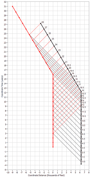

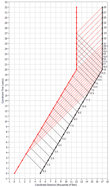

and in the "platform" frame, we might "explain" by saying that the Proper Length of the coil is 6250 feet originally and 5000 feet finally so it experiences compression.
You said that for the ground observer, he will not see any change in the train length of 5000 feet before and after stop according to your first diagram. So the compression wave which starts at A for the train observer should not be seen by the ground observer! at the time the train stops. If the ground observer has to see any compression, he should observe this force when the train starts moving. In this case the proper length of 6250 drops down to 5000 feet during moving.
It doesn't matter which frame we use to analyze or depict a scenario. They all will show that everything that any observer can actually see or measure is the same.

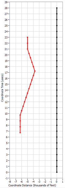

What I want to do now is show you how an observer riding at the rear (red) end of the train will measure the Proper Length of the train as it drops from 6250 feet at the beginning to 5000 feet at the end.
In order to do this, he will use a laser range finder which shoots a pulse of light to a reflector at the front (black) end of the train and how it measures the round-trip time for light to get there and back and divides that time interval by two and calculates how far light travels in that amount of time. For our scenario, I have defined the speed of light to be 1 foot per nanosecond (or 1000 feet per microsecond). Actually, the laser range finder also keeps track of when each light pulse was sent and when its reflection was received and it applies the calculation of the distance to the average of those two times. This holds to Einstein's second postulate that the light takes the same amount of time to get to a target as it takes for the reflection to get back, although Einstein only applied it to an inertial observer and I'm applying both during intervals when the observer is inertial and non-inertial.
We go back to the original spacetime diagram in post #3 except that I'm only showing the two ends of the train and the laser signals going between them. I had to extend the diagram at the beginning and the end to accommodate the laser signals and their echoes.
Here's the first diagram. The thin red lines going upwards to the right are some of the laser signals that the observer at the rear (red) end of the train sends out. I'm only showing the ones that hit the black dots representing 1-microsecond intervals of time at the front of the train. The thin black lines going upwards to the left are the echoes. I have marked in the times on the observer's clock when the signals were sent and received:
The observer compiles a list of the sent and received times and averages them to determine the "time" for which the measurement applies. He also calculates one-half of the difference between those same two times (in microseconds) and puts down the distance (or length) in thousands of feet to the front of the train. Here is his list of measurements in the first two columns and his calculations in the last two columns:
Code:
Sent	Rcvd	Avg	1/2 of
Time	Time	Time	diff
0	12.5	6.25	6.25
1	13.5	7.25	6.25
2	14.25	8.25	6.25
3	15.25	9.25	6.25
4	17	10.5	6.5
5	19	12	7
6	21	13.5	7.5
8	22	15	7
10	23	16.5	6.5
12	24	18	6
14	25	19.5	5.5
16	26	21	5
17	27	22	5
18	28	23	5
And from that, he makes a spacetime diagram showing how the length of the train gets from 6250 feet to 5000 feet. Along the way, it gets longer and then gets shorter. Keep in mind that when the two ends of the train stop at the same time, the front of the train initially experiences compression and the rear of the train experiences tension as shown in the diagrams in post #11 but after all the vibrations dampen out, the Proper Length of the train ends up at 5000 feet:
Now I want to show you that the observer makes exactly the same measurements and therefor makes exactly the same determination of the length of the train in the platform frame:
Can you see that even though the time for the light to traverse to the target and the time for the echo to get back to the observer are completely different in this diagram, the observer still makes the same calculations because he is assuming that those times are always equal?
Now what about the platform observer? Well, he can apply exactly the same technique to determine his distances to the two ends of the train and then make the same space time diagram shown at the beginning of this post. Then he can do the same thing that we did and determine the Proper Length of the train as it comes to a stop.

Here is the diagram for the IRF in which the train starts off moving and ends up stopped:
Here is the log of the data the observer takes and the calculations he makes:
Code:
Time	Time	Time	diff
0.5	13	6.75	6.25
1.5	14	7.75	6.25
2.5	15	8.75	6.25
3.5	16	9.75	6.25
4.5	16.5	10.5	6
5.5	17	11.25	5.75
6.5	17.5	12	5.5
7.5	18	12.75	5.25
8.5	18.5	13.5	5
9.5	19	14.25	4.75
10.5	19.5	15	4.5
11.5	20	15.75	4.25
12.5	20.5	16.5	4
13.5	21	17.25	3.75
14	22	18	4
14.5	23	18.75	4.25
15	24	19.5	4.5
15.5	25	20.25	4.75
16	26	21	5
17	27	22	5
18	28	23	5
Here is the diagram of the non-inertial reference frame he constructs from the log.
Note that the train doesn't get longer, rather it shortens to less than 4000 feet and then lengthens back to 5000 feet.
And here is the diagram for the IRF in which the trains starts out at rest and ends up moving:
Once again, the frame has no bearing on the measurements and observations that are made, including those of stress.

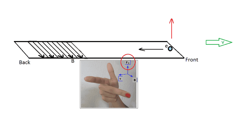

Here are 2 examples which I am just thinking about:
1) Consider a point charge located at the front end of the train and a magnetic field in the rear end where the magnetic field lines run perpendicular to the long axis of the train as shown in the figure. As the front end starts to move toward the rear end, a magnetic force will act on it and its direction will be determined by right hand rule. So, the point charge should move under the effect of this force in the upward direction, toward the roof of the train. Will that movement be observed in the platform observer?
2) How about gravitational force, how if there are 2 massive objects at both ends of the train. When the length shortens the force increase between them ( inverse square law), will this be the same for the platform observer?
Transform the coordinates:
http://farside.ph.utexas.edu/teaching/em/lectures/node109.html
and transform the fields:
http://farside.ph.utexas.edu/teaching/em/lectures/node123.html
Then apply the Lorentz force law.
That requires general relativity where the gravitational force does not strictly follow an inverse square law. We should stick with EM phenomena until you have learned SR.

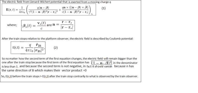

  • #55
adelmakram said:
Those transformation will not be applied in this case because the state of motion of 2 ends of the train are not the same for all reference frames.
Yes, they do apply. They apply any time that gravitational effects are not significant. The motion of the 2 ends of the train is not relevant.
  • #56
Fine, So would you please show how the platform observer could explain the upward motion of the point charge?
  • #57
