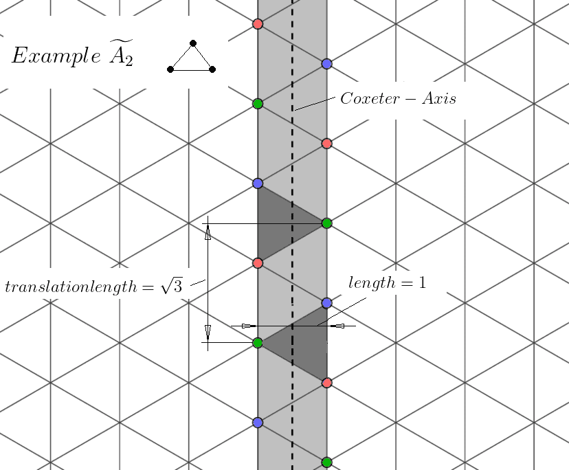

Maybe it is more clear with a picture.
The picture shows the affine coxetergroup of A2.
The darkgray chamber makes a reflection and a translation by the coxeterelement of affine A2.
My question now is how long is the translationlength by the coxeterelement of E9 (affine E8)?
We would need the graph for ##E_9##, not the simple one of ##A_2##. But as the ninth root is basically analogue to the situation of ##A_n## I assume it is ##\sqrt{3}## as well.
As i found out it cannot be ##\sqrt{3}## because the lattice of E8 have only half integers and integers coordinates.

I think i have found the answer.The translation is √2.
