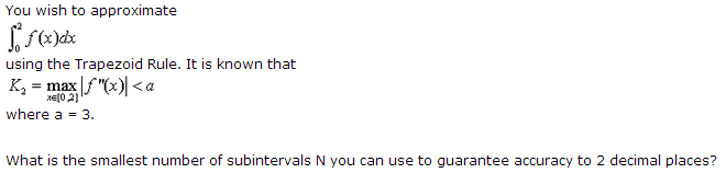

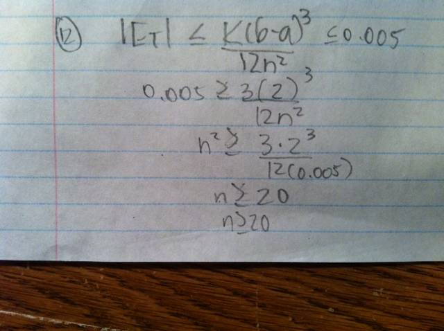

Thus my answer is N = 20.
I wasn't sure if I should use ≤ or just <. Also to get 2 decimal place accuracy would using 0.005 be correct?
Your work looks fine to me, but I think I would use < instead of ≤. If your error < .005, you'll be guaranteed 2 decimal place accuracy.
