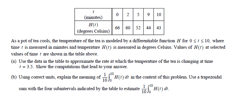

Part b.
Well I thought the trapezoidal rule was:
[tex]\int_a^b f(x)dx = \frac{b-a}{2n}[f(1)+2f(2)+2f(3)+...+f(n)][/tex]
But when I did that I got the wrong answer and the work shows a completely different formula that I didn't know:
The part I'm confused about is the (2((66+60)/2)+...)
(66+60)/2 is the avg height and 2 is thw dith of the segment so then 2*(66+60)/2 = area of that segment. add them up to get the approx area under the curve.
Why is there an 2, then 3, then 4, then1 infront of each of the areas of the segments :|

The first subinterval is of width 2 (sec); the 2nd's width is 3 sec; the 3rd's width is 4 sec; the last subinterval's width is 1.
