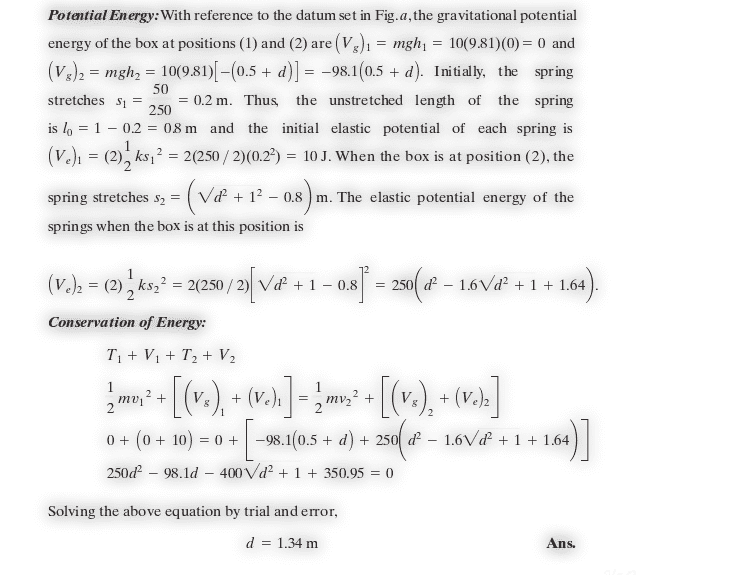

1. Homework Statement
A pan of negligible mass is attached to two identical springs of stiffness k = 250 N/m. If a 10kg box is dropped from a height of 0.5m above the pan, determine the maximum vertical displacement d. Initially each spring has a tension of 50 N.
The springs are each 1 m long.
F=-kx
W = integral of F with respect to dx
potential energy + work + kinetic energy = potential energy + kinetic energy
The question is solved by a solution manual online by considering taking the potential energy of the spring, the box, and the earth. The thing is, I originally never learned that we could do this. I learned that we can only take the potential with respect to one object.
Naturally, this confused me. Exactly what are the limits to taking both of these objects as one system? How would we handle kinetic energy (if both the spring and the mass were moving with their own independent velocities)
Here is how it is solved:
Yes, you can consider multiple objects as the same system. The kinetic energies (if any) add, and also add the potential energies of the forces of interaction.
Here the box and Earth interact with the force mg and the potential energy from that interaction is mgh. The springs interact with the box, and the potential energy of interaction between the box and one spring is 0.5k(ΔL)2 where ΔL is the change of length with respect to the relaxed length of the spring.
Assuming no loss of energy, the sum of KE and all PE-s is constant during the motion. At the end, the KE is zero, so the final potential energy is equal to the initial one.

But in the first snapshot, the box isn't touching the spring.
The pan has negligible mass, so it does not take away energy. Initially, there energy is equal to the gravitational PE of the brick, as the elastic PE of the spring is zero.
The final energy is the sum of the gravitational energy corresponding to the deepest position of the brick, and the elastic energy of the spring, as the KE is zero.
The solution says the initial elastic potential energy is 10J. Also, how would the pan take away energy if it had mass?
Sorry, I forgot that 10 J.
If the pan had mass, the velocity of the spring would change when it collides with the pan. If the collision was perfectly elastic, the brick would rebound and the motion would be quite complicated. But a collision is never really elastic, some of the energy would be lost . So the KE of the pan and brick would be less than the initial PE of the brick.
In the problem, the massless pan just holds the brick , as part of the ideal spring. So you can consider the process that the initial PE of the brick transforms to KE at the pan and that KE transforms to elastic energy.

It seems to me that the pan - springs system was set up
by stretching the springs. That is why there is stored
potential energy in the springs.
The OP started to write about a brick in the first post... But it is a box in the problem text.
Nothing was said about the set-up. I guess, the pan was connected to two horizontal springs.
