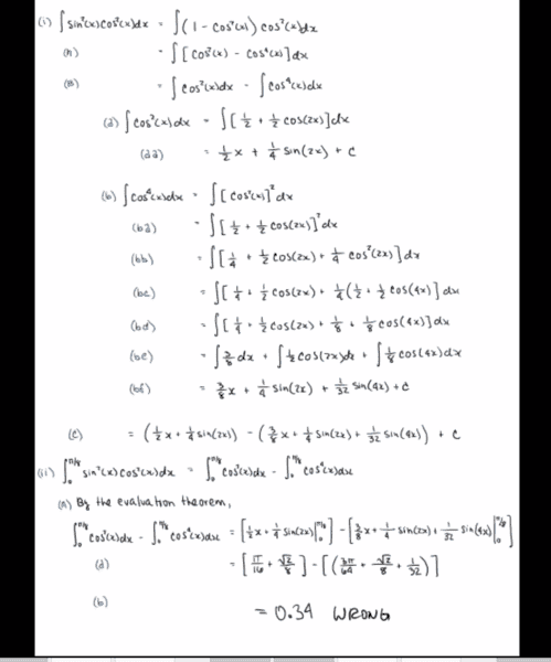

##\int_0^{π/8}sin^2(x)cos^2(x)##
Please see my attached work to see the train of thought. I've tried this thing about 100 times and still can't get the correct solution. I don't know if it's in the anti derivative evaluations of step (i) or the computation in step (ii)

I'm sorry to inform you that most members won't bother reading attached images. Since the image is hard to read (at least for me it is), all I can do is suggest you an easier appproach:
Observe that ##\sin(2x) = 2 \sin(x) \cos(x)##
Use this in your first step and your integral will boil down to (after a substitution) something like ##\int \sin^2(x) dx## which is a standard integral to solve.

Did you find the correct answer using your own method/my method?
What I did was just redo the computations in the evaluation theorem. Still trying to see how to use your suggestion in the first step.

##\sin^2 (x) \cos^2(x) = 1/4 \sin^2(2x)##

##2\sin(x) \cos(x) = \sin(2x) \implies \sin(x) \cos(x) = 1/2 \sin(2x)##
and then indeed I square both sides.

I use the standard identity ##\sin(2x) = 2\sin(x) \sin(x)##
This easily follows from ##\sin(a+b) = \sin(a) \cos(b) + \sin(b) \cos(a)## which is also a standard trig identity.
An easy proof can be given by writing down both sides of
$$e^{i(a+b)} = e^{ia}e^{ib}$$ using ##e^{ix} = \cos x + i \sin x## and comparing imaginary parts.
Knowing your trig identities can save a lot of time in such problems. Worth memorising imo.
