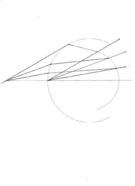

Is there an existing ray trace program that can trace planar light rays through this monocentric, model lens? Parameter values are given above. Input ray angles are all zero. Does some program give the output ray angle values at the second surface? How about for any arbitrary ray incoming to the lens, at any converging or diverging angle? Can the same program give the exit ray angles then? If so, what are the values of the output angles for your chosen input angles? And what is this software? Thank you.

2D. Only one wavelength. Just refraction checked. No reflection. No polarization.
Just the simplest conditions were wanted. Thick, monocentric model. Only theoretical at this time. Simple model.
However, I am contending the lens model is free of all spherical aberrations. That any arbitrary input ray angle will be reproduced at the second surface. My own trigonometric ray trace, homemade program confirms that this is true. I am looking for someone else to confirm this too. Or deny it. These are "perfect" spherical lenses, is my contention.

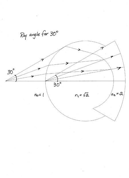

Here's a source other than infinity. 30 degrees incoming wave. Source point is 2 units before the center of lens. Same parameter values. Diagram shows output angles equal input angles.

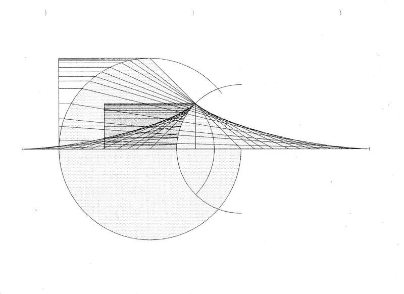

It is still unclear to me what you are attempting to show here. If you are correct, what is the novelty?
To show it correct you could try to trace one ray at the two interfaces. Maybe start with a symmetric one and show it in detail the refraction geometry at the two surfaces. How does your software do it?
The novelty is that it would be a spherical lens model completely free of spherical aberrations. Something that Hecht was correct in saying it probably couldn't be done.
Well, I have added more construction lines to the models I use than is shown here. Calculated more axis lengths and couple more angles. Well, if that's OK with you all, I'll provide the proof in diagrams. All trigonometry, law of sines equations a lot. I'll do it for the last diagram I posted here, if that's acceptable. It might take a little time to get a presentable package together, but I'll show all the angles and variable values needed. See if I can provide more proof, so you won't have to do the labor. I just had thought it could be verified easier. Is this OK?
But it would not be a singlet. So that is not what Hecht said. Am I missing something here?
Yes, possibly. Hecht did not speak of a singlet or doublet in particular, but said any "...real system comprising spherical surfaces." He says you probably can't get rid of all SA using only spherical surfaces. And I am trying to show that this model is the exception. That's novel.
I only refer to it as a singlet due the angles into it are the same as those that exit it. It would be a doublet in practice. I only want to show the equal angles property of the singlet. Little confusing, I think, for I've shown both.

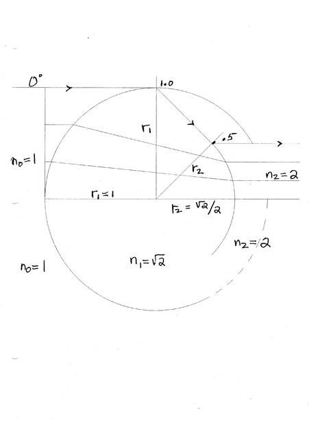

Here's the same diagram sans the last doublet surface. Now a singlet again. (Running out of ink in my printer too.)
I'll prove this diagram trigonometrically, if that is OK. Or attempt to.

But I'm a bit confused about your original drawing, are you using a different refractive index on each side of the lens? That's not very typical.

Yes, it actually is about exactly how you combine the radii and indexes together. Model rules. In the other post thread. This particular shape and combination of different indexes before and after a single, thick lens is unique in that regard. Only combination of shape and media that does it. For a spherical single lens, anyway.
Yes, refractive indexes are all different. Agree, not typical at all. But the singlet does become the doublet. You won't find this model in any textbook that I've seen.

Try the other lens diagram. 10, 20, and 30 degree rays from a source point 1 unit before the lens. Everything else the same. Check the output angles.

Instead, here's the case of the beam at a 30 degrees angle, this should convince you I think.
The output rays do seem to be quite parallel, although there's a small loss in precision:
Wow, that's very impressive. Beautiful color diagrams. Thank you. I don't need any convincing, but the scientific community does. This post was just looking for available software to ray trace the model. You've provided some now and shown proof, I think, too, of equal angles, in and out. Tremendous.

Yes, and the aberrations patterns match for all the other waves too. The air-to-solid refraction pattern matches its inverse, the solid-to-air caustic. Here's that other diagram also showing what you are saying.

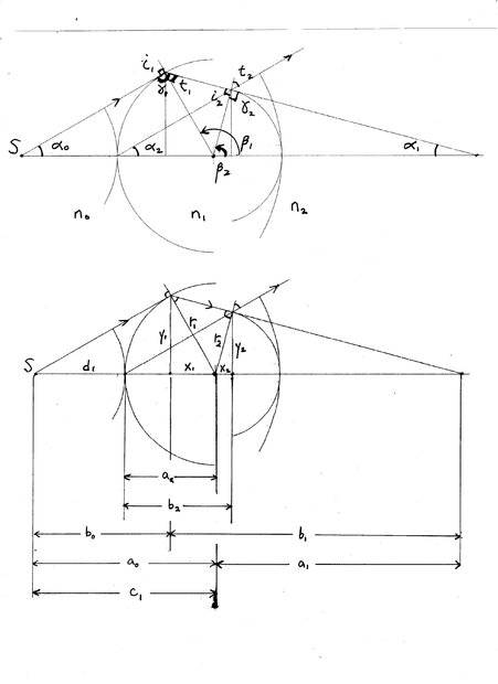

Well, since you asked, and since I needed to provide a proof and not just diagrams, and since the post title even changed too, here it is. A trig proof that the angle in equals the angle out for this model. Long process, but not as long as Conrady's. TGIF and this homework assignment is turned in on time!
This is my model, and most all of the variables, a fully Cartesian model. All variables positive, but some can also be negative, and I put a sign showing that above each variable when needed, for it affects the sign of the equations. Ray angle with x-axis is positive divering, zero when planar, and negative converging. Axial lengths are negative left of the lens center, positive to the right. The beta angles with the radii are always measured counterclockwise. Only the positive side of the x-axis is calculated.
