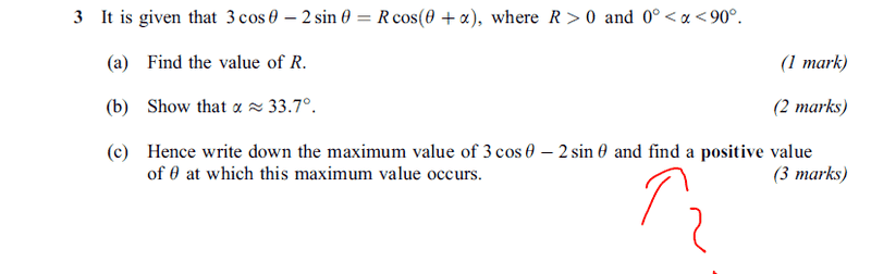

Hi
Its the bit (c) where i am stuck at although it doesn't look much complicated, for all i know is that max value for cos =1 , so cos inverse becomes 0. The answer on the mark scheme is theta = 326 which i can't figure out.Thanks

I'm just wondering, have you tried it? I would start by observing that
[tex]cos(\theta + \alpha) = cos(\theta) cos(\alpha) - sin(\theta) sin(\alpha)[/tex]
After solving for [tex]\alpha[/tex], you then can find a maximum [tex]cos(\theta+\alpha)[/tex] which when multiplied by R will give the answer to part (c).
If you need further help, post your work so far.

Ah how weird i just did another similar question of which i got the answers hmm anyway, here is what i did:
i got the R value square root. 13 (by equating co-efficients of sin and cos),
theta 33.7.

Note that [tex]cos(\theta+\alpha)=1[/tex] means that [tex]\theta=-\alpha[/tex]. However, the pattern repeats every [tex]360^o[/tex].

Oh! would i let R[tex]cos(\theta+\alpha)[/tex]= 1?

Not quite. Let [tex]cos(\theta+\alpha)=1[/tex]. That will give the maximum for [tex]3 cos(\theta) - 2 sin(\theta)[/tex] after it is multiplied by R. Since R is effectively a constant any maximum of [tex]cos(\theta+\alpha)[/tex] will be proportionate to [tex]R cos(\theta+\alpha)=3 cos(\theta) - 2 sin(\theta)[/tex].
