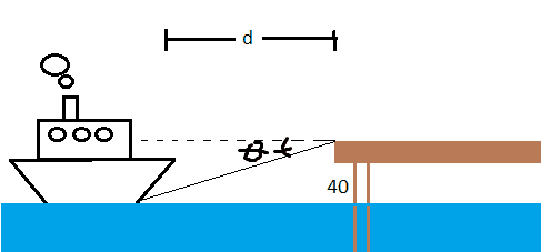

A ship is d feet from a dock (horizontal distance). The dock is 40 feet above sea level. The angle of depression from the dock to the ship is θ. Write θ as a function of d.
This question is accompanied with choices. The choices are
[tex](A) θ = 40arctan(d)[/tex]
[tex](B) θ = arctan(\frac{40}{d})[/tex]
[tex](C) θ = arcsin(\frac{d}{60})[/tex]
[tex](D) θ = \frac{arctan(d)}{40}[/tex]
[tex](E) none of these[/tex]
First, I would like to know if my graphical representation of this problem is correct.
Diagram of a ship at sea below a dock, with a horizontal distance d marked above, the dock height labelled 40, and the angle of depression theta from the dock to the ship.
Thank you!
Do you know the definitions of "sine", "tangent", etc.? If not, look them up. Once you know them you will see that this problem is trivial.
It is a very nice (and correct) drawing, with a very big ship.:smile:

Ok sir so if my interpretation of the problem is right, then it would be right if I answer choice B right? Thank you! :smile:
YES!

Yes! I made it right. I just wonder if my understanding was right because I'm not from an English-based country so some phrasing are not clear to me. Thank you everyone! :biggrin:
