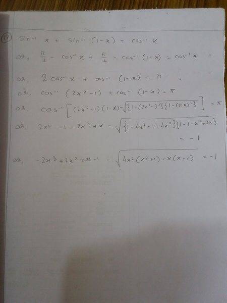

Solve for ##x ##: $$ \sin ^{-1} {x} +\sin ^{-1} {(1-x)} =\cos ^{-1} {x} $$
Answer given: ##0## or ##\frac {1}{2}##.
:[/B]
All relevant formulae on inverse circular functions may be used.
:[/B]
Please see the pic below.
I can't solve with the huge expression under root. How do I simplify that?

It is impossible to read your picture. If you want help from others, take the effort to type in your work.
Anyway, take the cosine of both sides, and replace cos(θ) with ##\sqrt{1-\sin^2(θ)}##
First you want it typed so others can read it.
Then you want it correct.
Under square root in last line you should have $$\left [ 4x^2(1-x^2)\right] * \left[ -x(x-2)\right] $$and then you want to solve.
From the fourth line, you get cos-1(2x2-1) = π - cos-1(1-x)
Take the cosine of both sides. Use the addition formula for cosine: cos(a-b)= cos(a)cos(b)+sin(a)sin(b). You get a simple quadratic equation for x, without complicated square roots.

I never said I wanted it to be typed. I did not have the copy at hand to change the image. I can't always sit with the copy, waiting to see if others can read from the image. I can read from the image very well. Perhaps you can't understand my handwriting. That's a different issue. I'll change the pic once I reach home.
I'll try that, but wait a bit. I'll try once I reach home.

Well, I'm only 68, so I'll have a go at reading the image.
You were doing fine until the last line. You've done something weird in expanding the terms inside the square root. You should e.g. end up with being able to remove a factor x (x=0 being a solution).
