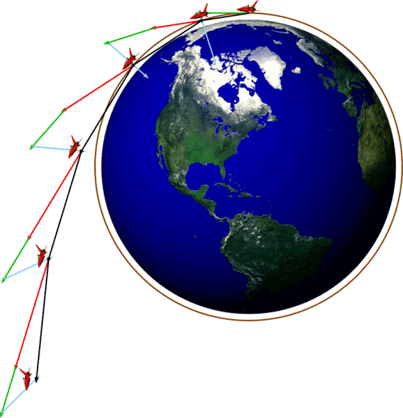

OK, I made a graphic to illustrate to myself what was going on and I think I see my confusion - sorta. In the images, the brown circle is the hypothetical "track" the ship rides on. Light Blue arrows indicate the vector for gravity, Red arrows represent the prior path carried forward to the next time block, Green arrows represent the acceleration vector and Black arrows represent the path traveled by the ship for the current time block. It's been too long since I had Calculus, so the direction of the acceleration vectors is just the starting position tangential to the track; I wasn't about to attempt to calculate the direction over the course of the track segment during the duration of the time represented.
Anywhoo, my intial take was to consider the Earth as a point source of gravity, so the acceleration of the ship to leave would be away from the point source and then, the gravity of Earth would cancel out the acceleration, giving a net velocity of 0;
But, the Earth, closer up, is a sphere. And, since the ship is on a track, the upward force of the track against the ship cancels out much of the force of gravity, until the point is reached where the gravity vector's magnitude fails to bring the actual path back down into contact with the track. But, by that time, the ship's velocity is enough to allow the further application of 1G acceleration to continue off-planet;
That is, if I've done this right - I think I have. But, still, my gut says it's wrong. The 1G of Earth negates the 1G of the ship, keeping the ship planet-bound. But, using the track seems to allow the ship to leave.
Although, I note that the Black actual paths, the first couple, anyway, intersect the Brown track. Should I have considered that this represents the ship coming to a stop at the point of the first intersection? If so, then my gut ends up being right and the 1G ship ain't a-goin' nowheres...

Although, I note that the Black actual paths, the first couple, anyway, intersect the Brown track. Should I have considered that this represents the ship coming to a stop at the point of the first intersection? If so, then my gut ends up being right and the 1G ship ain't a-goin' nowheres...[/QUOTE]
The black line are just an approximation of the path the ship would take if the track wasn't there (the actual paths would be curves). The track just prevents the ship from following that vector component of that path which points towards the center of the Earth. It provide the upwards force that cancels the Earth's gravity and allows the ship's rockets thrust to be applied to just increasing the speed of the ship.
You might try looking at it this way:
As the ship increases speed as it travels along the track, it is traveling in a circle. Objects traveling in a circle need a centripetal force acting on them in maintain the circular motion. (imagine the ship trying to travel in a circle in space far away from the Earth. It would need some inward acting force to keep it from flying off in a straight line.) For the ship on the track, gravity provides that centripetal force. At first, it is more than up to the task . But as the ships speed increases, the centripetal force needed to hold it to its circular path also increases. Eventually it will reach a speed where the Earth's gravity equals the magnitude of centripetal force needed. The ship has reached circular orbit speed.
The Earth's gravity is now just holding the ship to the circular path. Any further increase in the ship's speed means that the Earth's gravity is no longer enough to hold the ship to that circular path, and the ship will lift off the track and climb away from the Earth. As this happens, the Earth's gravitational pull also weakens. (if it wasn't for that fact, the whole concept of escape velocity wouldn't exist) This combination leads to the ship eventually leaving the vicinity of the Earth entirely.
