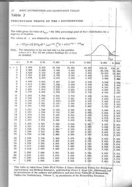

How to find percentage = 0.05 , while v = 45 using t -distribution table ?
Should i use interploation or just use percentage = 0.05 , while v = 50 to get the t value for percentage = 0.05 , while v = 45 ?
  • Scanned page titled Table 7, Percentage Points of the t Distribution, with columns for one-tail probabilities 0.10 to 0.0005 and rows for degrees of freedom v from 1 to 120 and infinity.
I think i should just use use percentage = 0.05 , while v = 50 , correct me if i am wrong
It might be OK in practice, but is not really correct. We have ##t(40) = 1.684## but ##t(45) = 1.679##. However, both of these round to the same value ##1.68## to three significant figures. So: you decide!
There are better tables available on-line; it just needs you to do a search.
how about ##t(50) ## ? can i use this ?
You tell me.
