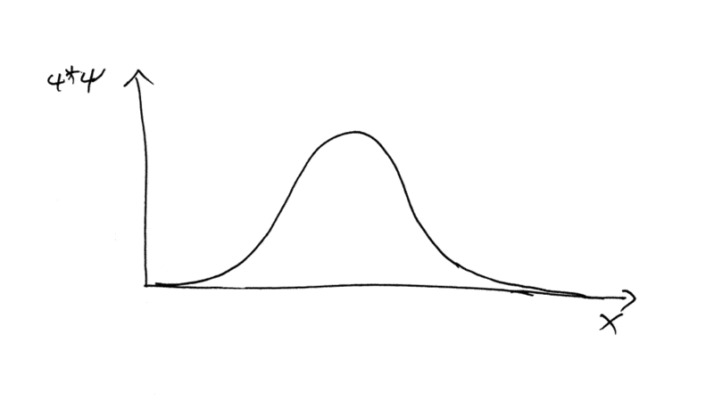

You're still thinking of real wave functions, not complex ones. When you use the complex versions and find [itex]\Psi^*\Psi[/itex], the "wiggles" disappear. The probability distribution ends up looking like this:
  • Hand-drawn graph of ψ*ψ against x: a single smooth bump rising from near zero, peaking around the middle, then decaying back to the x-axis.
ahh ok, I see.
I don'e know the reasoning behind it yet, but at least I know there's an explanation up ahead.
Thanks.
