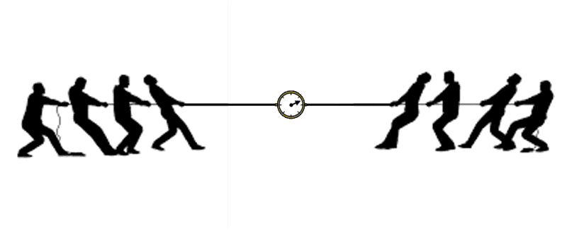

here you are considering massless string but i am asking you about massive string(m not equals 0)

If I may reiterate the answer to the original question:
The answer is yes. For a massive rope all of those possibilities exist; the bigger the net unbalanced force from A and B the bigger the acceleration. The tension in the uniform rope will smoothly match the external forces at each end and taper in magnitude linearly down the (accelerating) rope between.

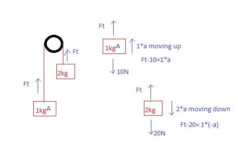

  • #39
Achintya said:
i totally agree with you with that wall example...but in that case basically we have equal forces at the two ends of the rope because of Newton's third law and thus the tension equaled the magnitude of the two equal and opposite action-reaction pairs...but where my confusion lies is that what would happen if the system somehow accelerates(which is only possible when the forces at the two ends of the ropes are unequal)...so for that case what would be the tension in the string...see according to me at the end of A(exerting 20N force), the tension of the rope segment joining the man A should be 20N (Newton's 3rd law)...correct me if i am wrong here...then same is for other end B(where the force exerted is 30N)...then the tension of the rope segment lying between these two segments will range from 20 to 30N ...also correct me if i am wrong here
Now, replace the wall with another person holding the rope. Unless they move, they are no more able than the wall to pull with a lesser force. And, if they pull with a greater force, then you have no choice but to move or pull with the same force. Or, let go of the rope.
You must match their force, move or let go.
In other word, the people have the freedom to pull with different forces, but if they do, then motion must result. There cannot be what you demand: people pulling with different forces yet no motion. That's physically impossible.

That's what i want to know that in this case, if A is exerting force of F1 and B is exerting force of F2,,,then the tension at the end of A and B will be F1 and F2 respectively..(acc. to Newton's 3rd law?)...if YES then my last question is will the tension at the end of A remain unaffected by the force exerted by B?
  • #56
Yes, but remember that:
- if we are to take the rope as massless then F1and F2 must be the same.
- if we take the mass of the rope as very small yet F1 and F2 differ significantly then the rope will have a great acceleration, so the bodies at the ends of the rope will also have a great acceleration.
Your basic misunderstanding is that you seem to think that, say, two people can pull on opposite ends of a rope each with whatever force they care to apply, independently of the other. This is simply not true. Take an extreme case: there is no-one on the other end. You can try to pull hard on your end but you will not succeed. You will fly backwards and create very little tension in the rope.
The tension at end A will equal the force F1. The ability of the body at end A to exert a force on the rope may be limited by the body's own inertia - as in my one person tug of war example above. If the force F2 is increased it may allow F1 to increase as well, so whether F2 affects the tension at end A depends on what you mean by that.
