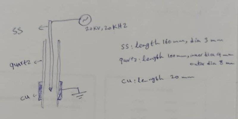

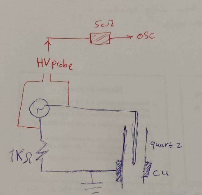

There is a one k ohm resistor between the power supply ground wire and the ground electrode of device. high voltage probe connected to oscilloscope through 50 ohm connector.
the device (plasma jet) made up of: SS 3 mm diameter rod connected to high voltage inserted inside a quartz tube with 4 mm inner and 8 mm outer diameters. Cu tape around quartz at the bottom is the ground. we must have a discharge within the tube between anode tip and the Cu. but it's strange that with such high voltage we can not get any discharge!

The 1k resistor from ground to "ground electrode of device" is probably there to conduct leakage currents, to prevent voltages floating and breaking down the insulation. I do not have the schematic diagram of your circuit, or know which particular "device" you might be referring to.
You can post a link, or attach a picture to a post.

The dimensions of your discharge tube are almost certainly not the problem. There is something more obvious missing. Like, how the generator current is limited.
How is the ground of the generator connected to the discharge tube?
Where in the circuit is the 1k ?
