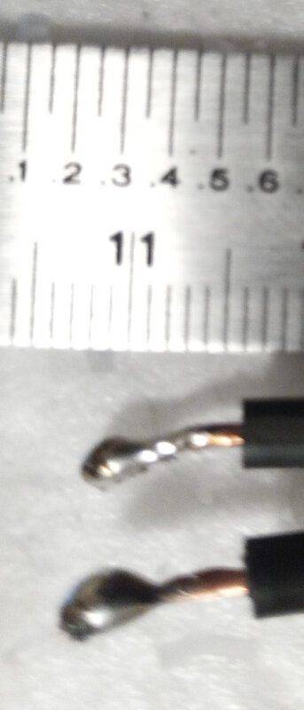

I had a friend send me an LED strip with a USA wall ac to 12v dc PSU, so I slapped a 3-pin wall cable on it and spliced a toggle button into it. Everything works fine buuuut...
If I put my finger here (assuming it's a resistor?)
I get some current, like so, even when the toggle's off
Either the toggle's crappy or I screwed up my solder work somehow (and I don't see how). Do I have a fire and/or shock hazard?

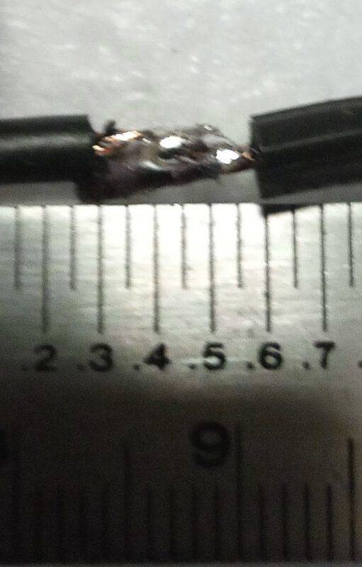

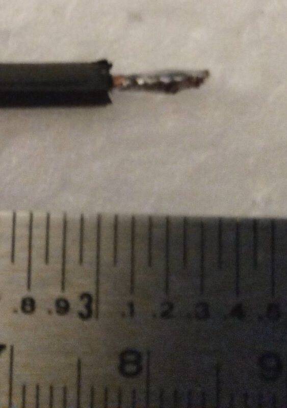

For sake of completeness, pics of solder work are below. Of course, critique of solder work is welcome and appreciated. The only thing I can't do is open up the toggle switch casing because it has some weird tamper proof screws.
From what I can see of your totally out-of-focus pics of raw solder applications, they all look really bad ... as though not enough heat were applied so the solder didn't flow properly.
I'm going to second the above and say that solder technique could use a little work. But that wouldn't cause the issues you're seeing.

Yup. A "cold" solder joint. Although that's probably not your current leakage problem.
The right way to solder is to first align and hold the wires together so they won't move.
Then heat both wires together ( adding a bit of solder early can help with heat flow).
AFTER they are hot you add the solder and let it flow throughout the joint.
Then remove the heat and don't disturb it for a few seconds as it cools.
Good Mil/Industry practice would be to not splice wires this way without additional mechanical support (like a crimp connection, or heat shrink tubing & cable ties, for example). But you may not care about that.
You will want to make sure that you are putting the switch in the hot side, not the neutral side, assuming you are switching the AC HV side. If you don't know what this means, then you shouldn't be doing this sort of work without studying a bit more. Or, switch the low voltage DC side of the PS instead.
We aren't going to be able to tell you if you put the switch in the correct place without detailed documentation. Your pictures only show a solder joint, basically. I suspect the problem is more about the schematic or components. There are several ways to do this wrong, and we are not clairvoyant.
Finally, you ask if you have a fire/shock hazard. This appears to be a simple modification. If you don't already know (for sure) that it's been done safely, then my assumption is that it might not be safe. Never, ever, ever would I tell someone they've done this right without a complete description of what they actually did.
edit: I should add: How do you know if the wires are hot enough? You melt the solder by touching it to the wires, not the soldering iron. Your wires need to be hot enough to melt the solder you add. The soldering iron's job isn't just to melt solder, it's to heat the items you want to solder enough so that they can melt solder without touching it to the iron.

By the way, your soldering job looks good to me, being out of focus it's just a little hard to inspect.

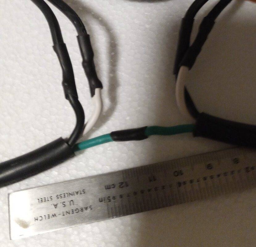

Thanks so much for the replies everyone. Since the consensus seems to be that the joints are bad, I'm going to redo them in the next few days and post new pics.
Thanks again
Joe
Twigg said:
What makes you think the toggle cause this problem on the strip? Didn't you put the toggle on the mains power cable?
I think the toggle is the problem because, other than trimming for length, I made no changes to the strip whatsoever. And it's a solid state device with no moving parts.

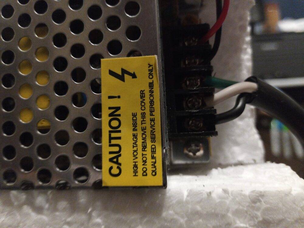

Could you please upload some pictures about that PSU and that how it is connected (to the LED strip, to the switch and so)?
Here's the PSU terminal block. Green black and white cables are AC wall power, red and black are DC out (led strip). The label's buried, I don't want to disassemble it until I decide how I'm going to rewire the whole mess in a couple of days. The picture with the 5 wires in the first post shows how the switch is spliced in.
I see.
Some such PSUs has a symmetrized EMI filter on the input side, like https://www.digikey.se/Web%20Export/Supplier%20Content/Lambda_285/PDF/TDKLambda_all_about_emi_epmag.pdfon the first page.
If by any reason the protective Earth is not present or not good enough or has some localized issues, then such filter will generate a half-line voltage lingering around on device chassis. It's through high impedance so it's not dangerous, but it might be enough to light up some LEDs or create small sparks or prickle you.
This matter might involve the local safety code so at some point you might need to contact a qualified expert.
Or, you can simply move to a double-insulated PSU instead. That's expected to solve the issue.

Even I would not splice a switch into the middle of an AC Mains power cord. If it's a 2-prong plug, you can get little inline switches at the hardware store that clip onto the cord and use insulation displacement connections -- they generally work well.

Is it just me or does that PSU look like overkill? How many feet long is that LED strip and how many watts is that PSU good for? If you can get away with a wall wart it will make this project much simpler (and significantly cheaper / more profitable). If you're going to do projects like this for a living, not having to mess around with AC power cables will reduce your costs and spare you a metric crudton of liability. Not saying you shouldn't learn, but knowing what you need is important too
I'm restraining myself from ranting about tools here and waiting for your new workbench thread :nb)
No, the LED strip is rated for 12v, I checked - it's super bright, I had to cover it to keep from frying my eyeballs. Although, running it at a lower voltage may be worth a shot.
No don't do that. Typing my full reply up now.
Edit:
I'm asking you about the power the strip consumes, not the voltage. The strip takes 12V, but how many watts? If it doesn't say the watts anywhere, does it indicate the amps? If you don't know, try seeing if the LED strip has a part number and googling it. The manufacturer absolutely should provide this information in their specs. Usually they give a spec that's watts per foot. Multiply that by the length of your strip and that gives you the total power consumption.
Edit edit:
If you want to dim the LEDs you need a PWM controller.
Edit:
Edit edit:
Like I said, the label on the psu is buried an I'm not going to dismantle it until I decide on a rebuild in a couple days. I'm not using it until then. Thanks for the pwm hint, I'll look into that too
Twigg said:
Edit edit:
Not necessarily. The photo in the first post seems to show a surface mount resistor, presumably to set the current thru the LEDs. If that is the case, then lowering the voltage would be an effective way of reducing the brightness.
