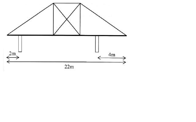

A horizontal truss, symmetric around its center, of mass 15,000 kg and total length 22m, is placed on two posts as shown in the figure
Find the downward force that it exerts on each post.
do i just take the force (weight and multiply it by distances?)
I have no clue
can someone give me a hint?

do I calculate torque?
Yes, sum torques about one of the support posts = 0 to calculate the force reaction of the other post. Do the same thing in summing torques = 0 about the other post to calculate the force reaction of the first post. Check your work using Newton 1 (the equilibrium condition) in the y direction.
Note: In actuality, a truss should never be supported this way, the supports should be located at a joint. Doesn't change your answer. though.
do these answers make sense??
so F Right post= 82771.875 N
and F Left post = 64378.125 N
Almost spot on! :cool: I say almost, because there should be just 2 significant figures in your answer. Implying Force right post = 83000 N, and F Left post = 64000 N. Or something like that. At least, get rid of the decimal points! :smile:
